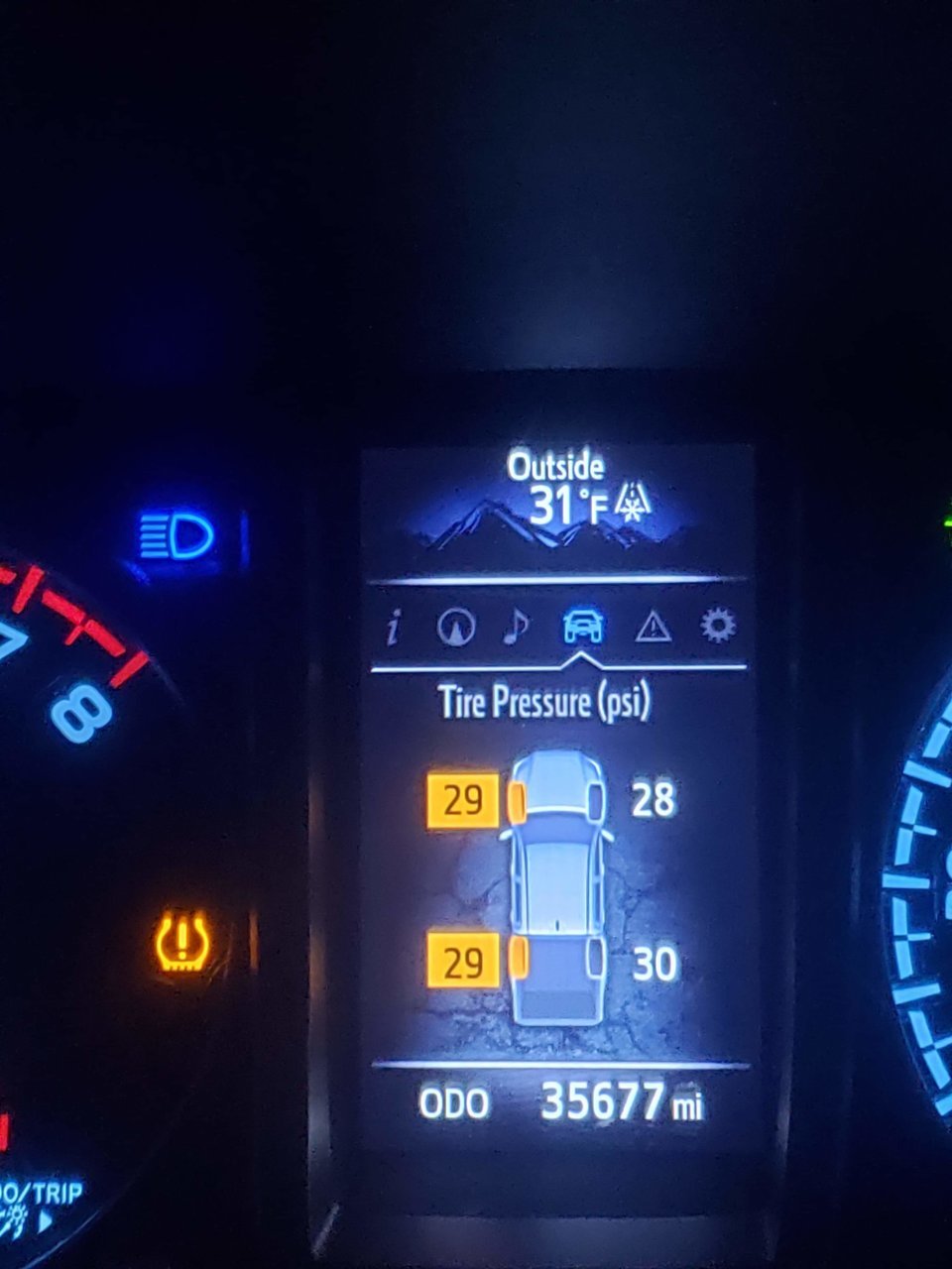

    My truck always read low tire pressure. I understand it should be like 34 but with cold weather is gets lower. Main question is my left tires both read 29 in yellow (reason for the alert being on). My rights read 28 and 30 without the yellow. Why does the 28 not have the yellow around it. Makes no sense to me.

    0xDEADBEEF

    Is 28 the top of the range for the front and 30 the bottom for the rear? Sounds unlikely but I can't say I remember what the manual says specifically. Or maybe there is a problem with those sensors and that is why they are yellow?

    His left front reads 29 and is yellow. His right front reads 28 but isn't yellow. That's what OP is referring to

    Yeah, I was saying that 28 could be the max for the front and 29 is too high. I know this isn't correct for the vehicle, just spitballing how it could give a yellow warning for those numbers. Low battery or something is what I'm putting my $ on.

    I see what you mean now. Although they said 34 is what the normal cold reading should be. Regardless, OP needs some more air.

    The front passenger tire was lower the last time TPMS values were set.

    Get a manual tire pressure gauge.
    Go to the closest gas station that has an air hose.
    Bring all tires up to the proper pressure.
    Reset the TPS system.
    Go on about your day.
    Simple.
    Don't rely solely TPSM system alone.

    and the sensors only alert you when that particular tire is a certain amount lower than it was when set last. Just this week I had one tire that was yellow at 28 as it bounced between 27 and 28. Then as they warmed, it was normal at 28, before it went up to 29.

    The reason not all of them alert you is when the TPMS sensors were "learned" they miight have been different pressures. The alert goes off when there is a % drop in tire pressure from initialization, not after a certain threshold (28psi). So once it drops 10% (don't quote me on the % decrease) from initialization, it alerts the driver. In theory if all 4 tires were inflated to 'exact' PSI and initialized at the same time, it should all be in the same. Hope that makes sense, I haven't had my coffee yet.

    What the guy said above. Most systems look at the delta between the current reading and the reading when the system is reset
