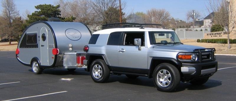

    They did the same thing back in '07 with the FJ Cruiser, 4.0L V6. Turns out it was just a suggestion, not at all necessary.

    ^The 2007 FJ was advertised with 239 hp / 278 lb-ft on 91 vs. the Tacoma's 236 hp / 265 lb-ft on 87 at the time, so a loss 13 lb-ft on 87.

    I've tried high-test and straight gasoline on my FJ and I can't tell any noticeable difference in power or mileage.
