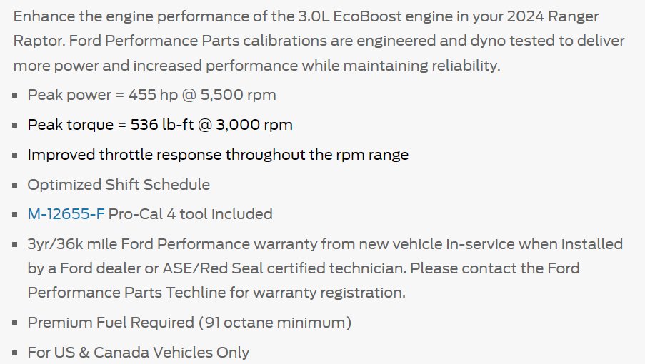

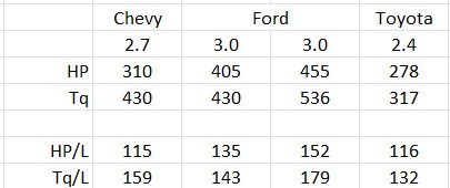

    Speaking of tunes and octane. Ford has the new tune for the Ranger Raptor that bumps up HP by 50 and Tq by 106. Premium is required, but it's already recommended.
    Comparing output per liter from Chevy, Ford, and Toyota, Chevy and Toyota put out about the same HP but Chevy makes significantly more Tq. Ford was cranking out more HP and Tq somewhere in between Chevy and Toyota. With the new tune, Ford is in a completely different league. These aren't race engines and I don't believe that Ford's fuel injection/cylinder head flow/combustion chamber design is vastly superior to Chevy and Toyota's. So is Chevy and Toyota just sandbagging or playing it that conservative? $825 for the Ford tune (which maintains factory warranty) is not going to offset the cost of replacing engines.
