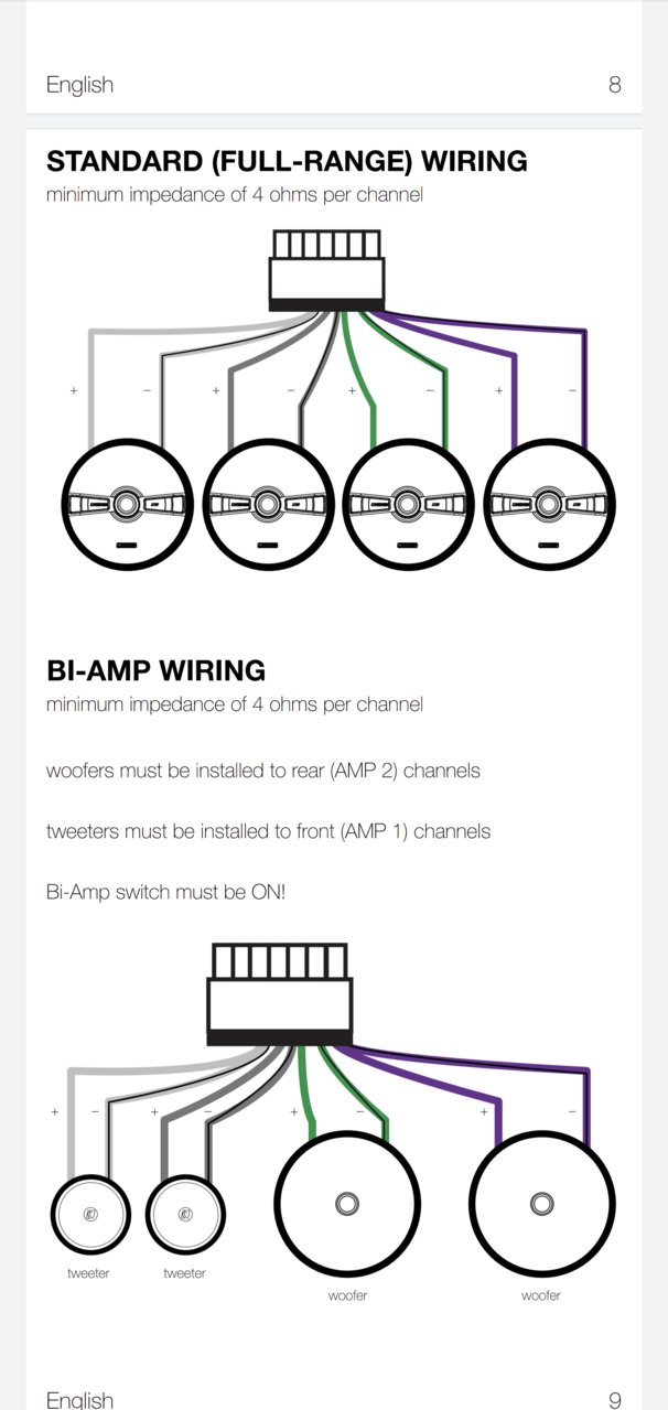

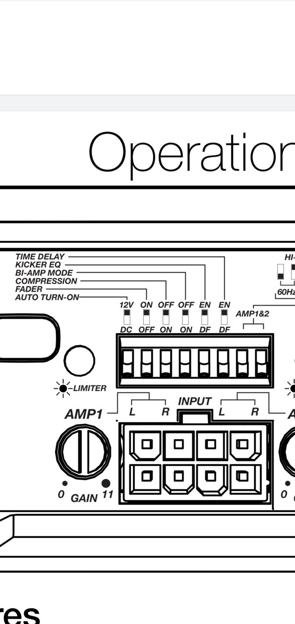

    Kicker key only goes down to 4ohms.
    Reading the manual makes it look so good. My speakers are 2.5 ohms. Plus the 20mx Which are another 2.5ohms.
    The manual says the amp supports a bi-amp mode.... "The Bi-Amp mode is
    to be specifically used without passive crossovers.
    Possible usages are with component speakers (two
    woofers and two tweeters), or with door woofers
    and dash speakers. Once the Bi-Amp switch is ON,
    the KEY amp will automatically detect and apply Bi-
    Amplification settings during the KEY Auto Setup:
