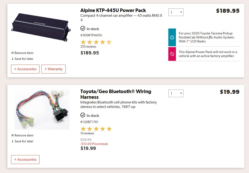

    See this thread. I installed the Alpine Power Pack instead of the Key. It's pretty much the same thing but I got a great deal on it on Amazon so I couldn't pass. Makes a huge difference and it runs off the stock radio wiring. So no need to go through firewall and can create a harness completely outside of the truck. No cutting anything factory.

    Do you need to go into engine bay for wiring here, or does it plug and play into stock head unit on ‘17?

    Thanks - I’d much rather do this then. How different was the install to the Kicker Key? Is this amp plug & play?

    It’s not plug and play out of the box. You can make your own “T” harness so that you won’t have to splice into stock wiring. Only then would it be “plug and play”.
    Edit: Although it’s not recommended to run power from behind the head unit, I’ve done it and it has been running flawlessly. (Knock on wood)

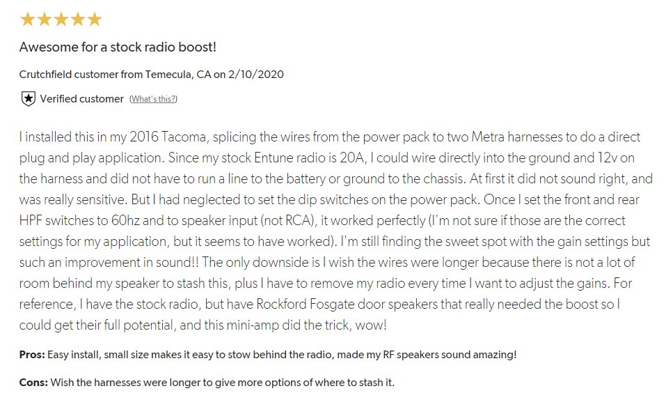

    Is this all you need? Maybe two Metra harnesses?
    I'd like to copy what this guy did in this review I'm pasting in

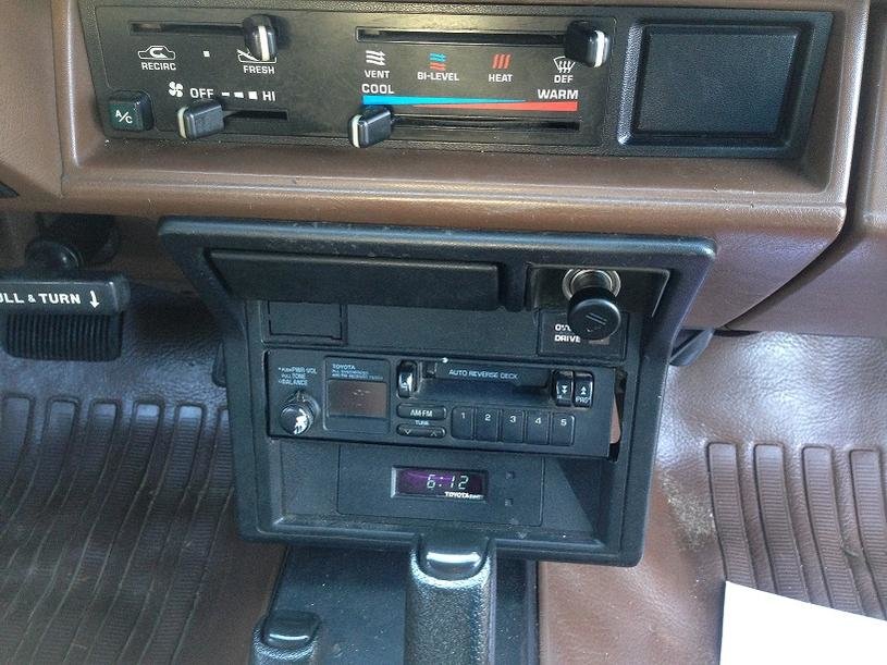

    Agreed, my 86 used to eat tapes - that was a PITA.
    AutoReverse tho;

    It's pretty much exactly the same. I wanted to get the Key for the auto adjust but found an open box Alpine for under 100 on Amazon. So I couldn't pass that up. It's not plug and play because you have to create a harness. The harness is combing the amp wiring and two different metra harnesses. I forget the part numbers but that thread lists them. Once you have the harness made though it plugs right into the stock harness with no modifications to the stock wiring.
    This is a simplification but either amp installs basically inline between the headunit and speakers. Take the speaker outs from the headunit, connect them to the in on the amp and then connect the out from the amp to the in on the speakers if that makes sense. Tap into the stock radios power, ground and remote on (may not be needed but I did to be safe) and you're done.

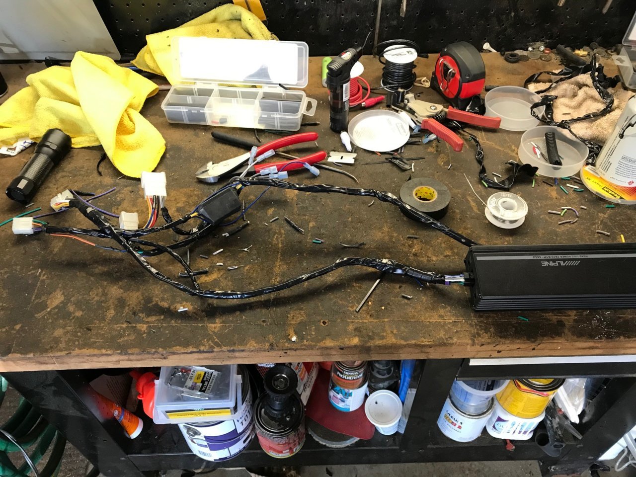

    Yeah, you need two metra harnesses. This is what my finished harness looked like. The four plugs on the left are all that needs to be wired up and I made that on my workbench.
    I trimmed the wires on the harness so all four plugs were in the same general area. Makes for easier wire routing and less of mess behind the stereo when installed. I put the amp right above the glovebox.
    I used Infiniti reference door speakers and kicker tweeters. I also added a kicker 8 inch hideaway sub (those are the blue plugs in the middle of the harness). I'm really happy with the sound. To me it sounds like a really good stock stereo should sound. Won't blast out the windows but is nice and clean with decent base.
    I'd rate this a 4-6 beer job.
