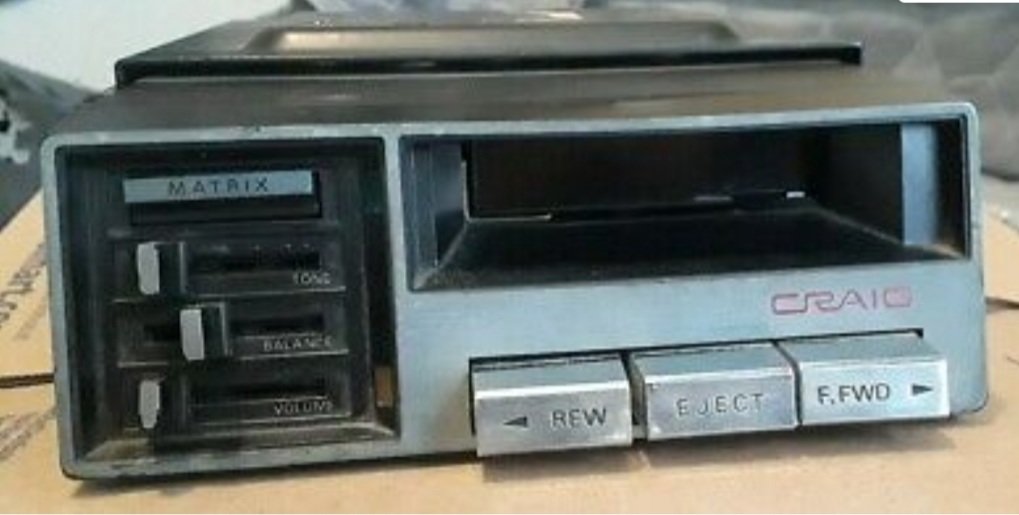

    cctk2
    cctk2 GLACIERBIRD
    Jun 18, 2010
    #39136
    953
    Chip
    NorCal and Alaska
    '68 FJ40, '16 TRD AC OR A/T WHITE
    Accessories: SnugTop Rebel canopy AVS Window Rain Deflectors TACOMA 6' Bed Mat Weathertech Mud Guards (4) Scanguage (re-installed from the '02) Tekonsha Voyager Brake controller (Chalet A frame pop-up.) Vinyl letter insets for tailgate. Garmin CS60 GPS mounting. Other misc décor in the form of decals.
    This was my silly beast. Had it, AND a secondary equalizer mounted... jammed more like it, into the gloves in the FJ40
    Junkhead likes this.
