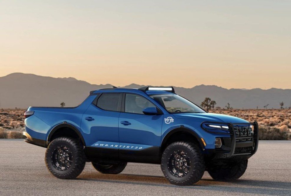

    Do you even lift bro?

    the beak off that back end.. it looks like it made that face mother warned it not to and actually got stuck that way!
