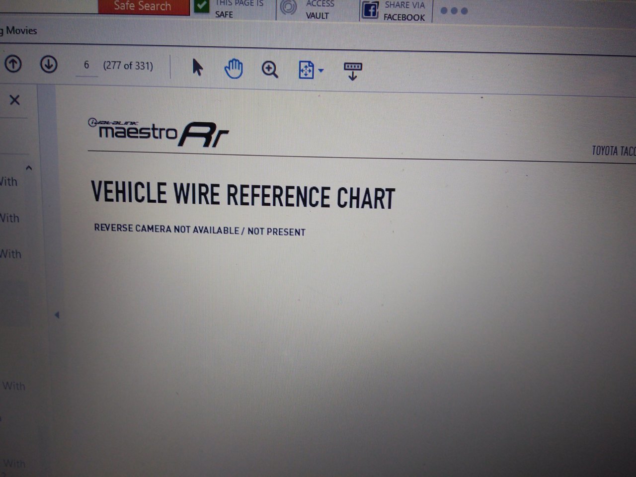

    On the factory plug, which wire from the Maestro goes where?
    There are no instructions for the Maestro on this as far as I read.
    Edit: for the backup camera.

    The function of the pins on the maestro changes depending on the firmware installed in the maestro. That is why they sell a harness for the Toyota which is what comes with instructions for the different Applications in your vehicle.
    You can get away without the T01, but I wouldn't go through the struggle.

    I have everything setup except for the backup camera. I am uncertain which of the 4 wires for the backup camera go to which pin on the factory connector as the OP did. Everything on TW simply states to tap into the red and black wires. One post mentioned the other two wires but didn't say which one is which.
    There's no instructions on how to do it for a 2011 on the instructions with the Maestro, it's a blank page.

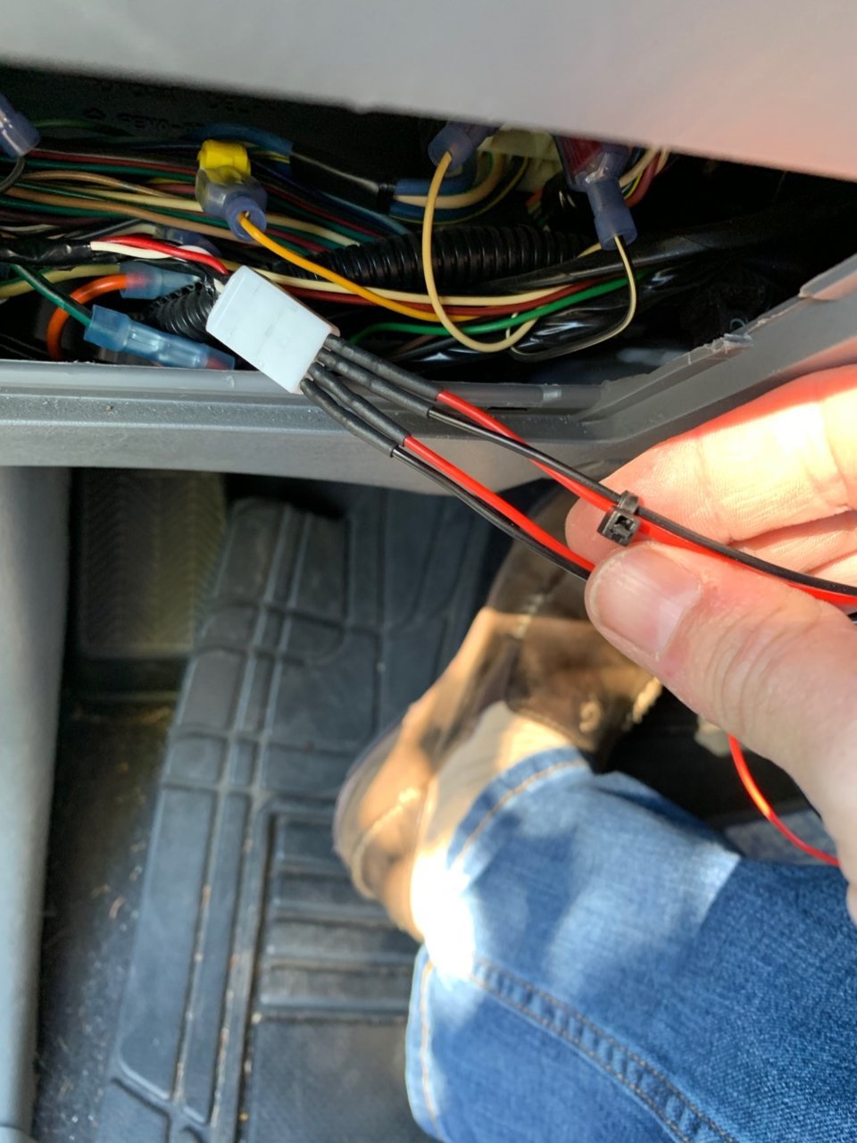

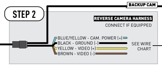

    Did you check out that thread where the dude was pointing out the wires? I started there, then ended up doing this:
    The two wires that are zip-tied are 5V power and ground. On the Maestro there's a little plug with 4 wires coming off, colors are blue/yellow, black, yellow, brown. Looks like this in the Maestro install instructions:
    So I wired yellow and brown to the pins that they talk about in that thread, and then blue/yellow and black to the other two pins (I had to extend the wires to reach the harness and I just soldered on standard red/black). Rather than tapping into the existing wires that were there (like they did in the thread) I just unplugged the harness altogether and inserted my wires with crimped-on pins into the female ends. Then I electrical-taped the whole thing up so they wouldn't fall out. I have this set for the crimp-on pins but you might be able to find them at a local Fry's: https://www.amazon.com/gp/product/B01G0I0ZZK
    Let me know if that helps!
    genconex[QUOTED] likes this.
