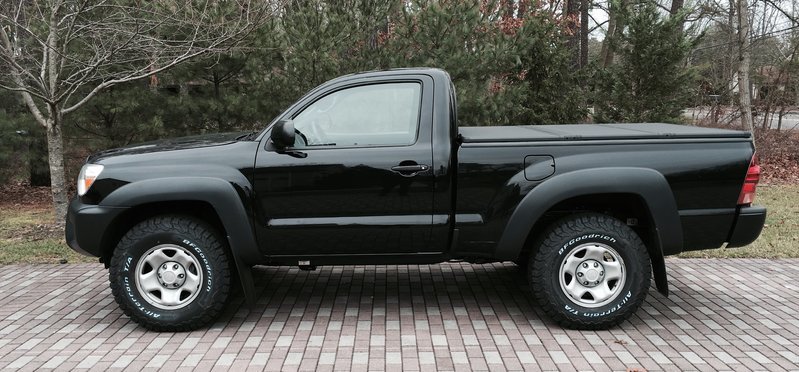

    Yes, I run 235/85's. I like the look better than 265/75's

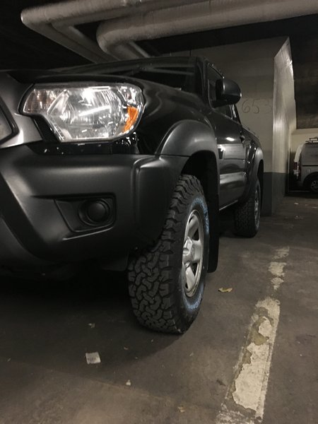

    i have 235 85. fits on stock.
    i love it. i think that size vibes with the 4cyl particularly well.
