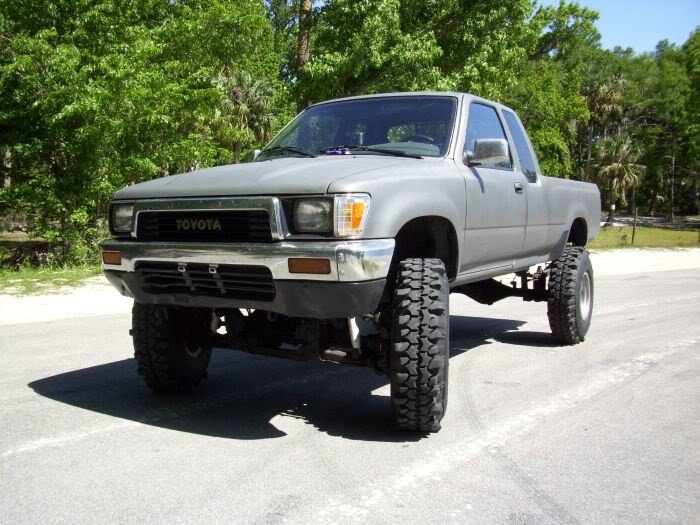

    34x9.5s baby:

    Had to look those up. Thought the image was altered. Nope. Makes sense when you think about it. More pounds per square inch.

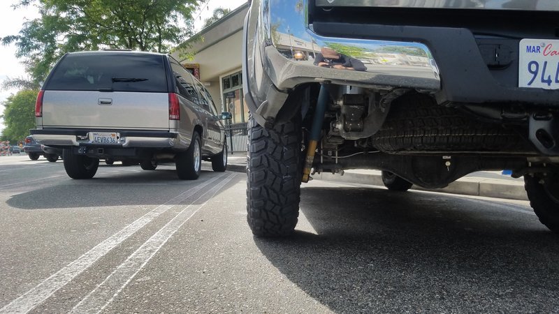

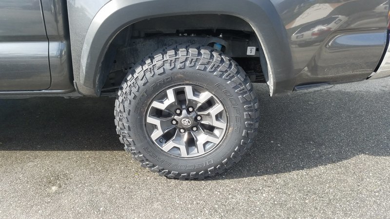

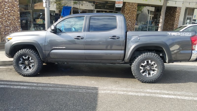

    These are definitely Mud Terrains, they drive like it and sound like it. The only reason I didn't go BFG-bro, was that the STTs in this size are a little taller. Haven't flexed them but at least at full wheel lock and up on a curb, no rubbing. Mall crawler status. I won't get her dirty until I do the Mojave Road early next month.
    They are skinny... Wowzers. But im leveling out the front end with Bilstein 6112s and 5160s in the rear so at stock-ish height it doesn't look too bad.
    This is all shorter term build until I figure out if I am going to 35's or not

    You'll love them offroad! And yes, the are skinny! Make sure you rotate every 3,000 or they will cup bad.

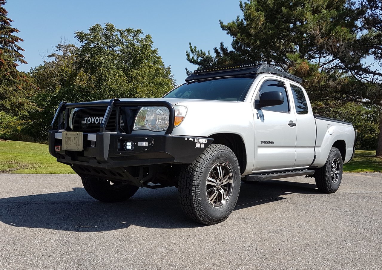

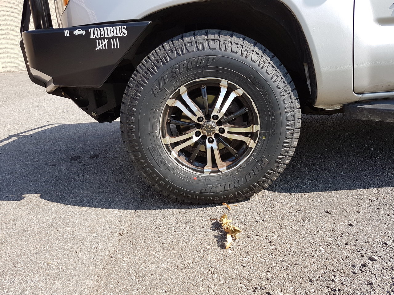

    My upgrade using the 235/85R16's (31.7") is a little different from most - 5-lug Tacoma that came with the Corolla (jokes) spec 215/70R15's (26.9") originally. To achieve this also required a full replacement 3rd member assembly with 4.10 gearing. Original was 3.31 gearing, optimal for the 235/85R16's is 3.91 gearing. I'm also running an Eaton Detroit TruTrac LSD.
    Rims used are aftermarket 16x7 5x114.3 pattern with +40 offset intended for early 2000's Wranglers and JK's. Tires are the Pro Comp 235/85R16 AT-Sports. This is primarily a road truck, with the occasional foray on a farm trail.
