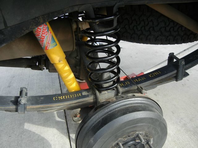

    having a 2018 tacoma sport trd , now have the sagging issues at the rear suspensions and lean to one side. Spoke with a shop and he suggested that add a pair of coil spring just above the leaf, so the whole system can last longer. I am not sure if this is going to work.
    Any suggestion?

    Well, that looks interesting.
    How is it working out for you?

    The photo shows a 1st gen. The 2nd/3rd gen bumpstop strike pad doesn't protrude far enough from the frame to retain a coil spring, so some custom fabrication will be needed. At that point you might as well just put in an AAL.
