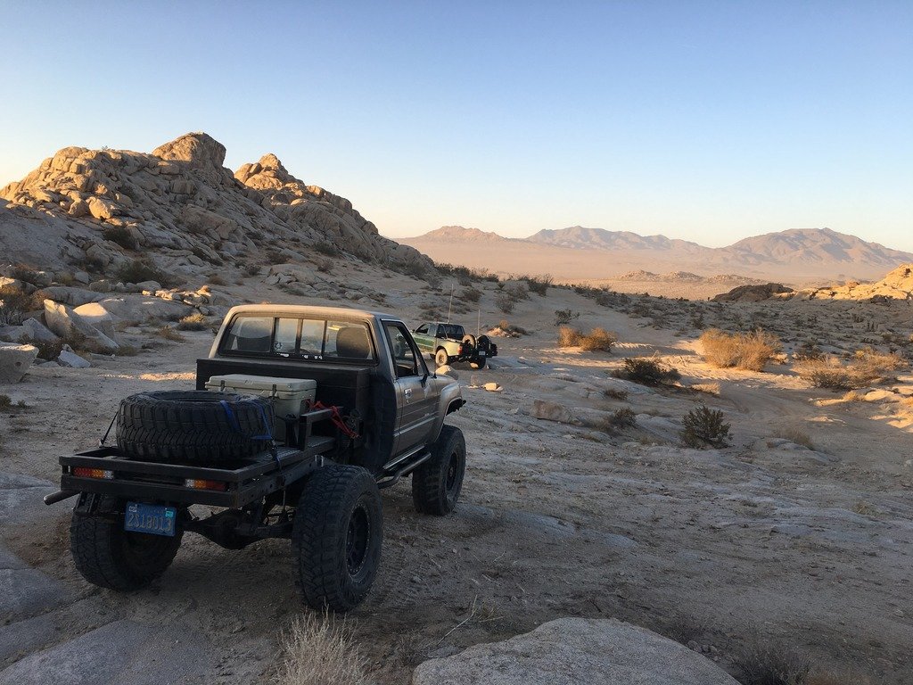

    Not a Tacoma nor is it complete, but here is mine. It is minimalistic and holds whatever I need to go wheeling. A full bed would be the first thing to get wrecked. A flatbed is modular. I can weld anything to it in the location I need it, whether it be tie down points, storage, mounts (spare, hi-lift).

    Yeah. You tagged me 'splain myself. Or at least the concept and some reasoning for the inquiring minds. Lol.

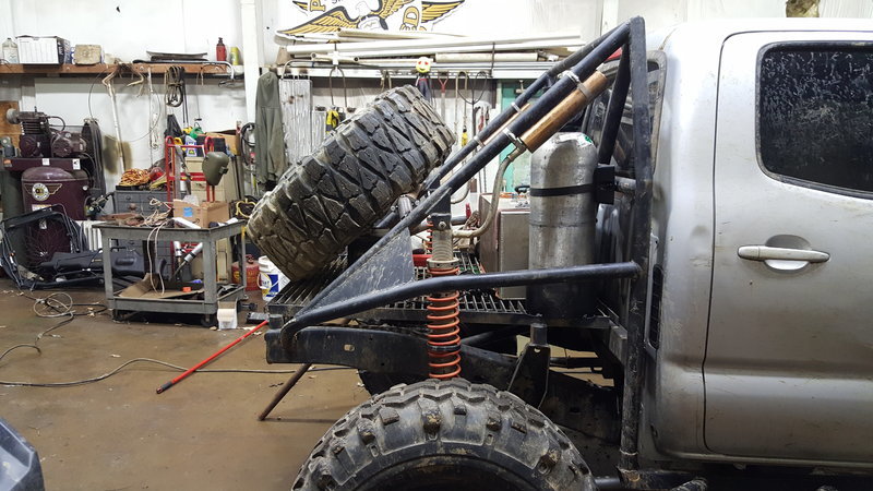

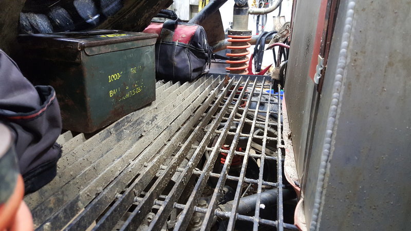

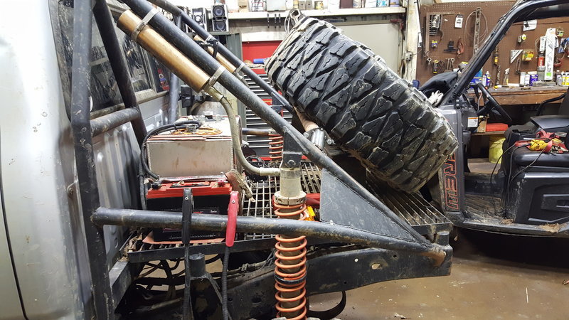

    Here is mine. I kinda did a "truggy" bed but I used grating for the floor material as it has an infinite amount of tie down points20170116_194338.jpg 20170116_194320.jpg 20170119_200355.jpg
    I used to also be a long bed but I didn't like the wheel base so I shortened it up which mentioned I had to ditch the bed anyways.

    Mine was going to be a bobbed bed, but then as I was taking the bed off to work on the rear end, I realized the last thing I want to do I lift that bitch back over the rear and then have to deal with replacing stripped 30 year old mounting bolts.
    It worked out as I had a shitload of spare 2"x2" tubing to make the bed frame.
