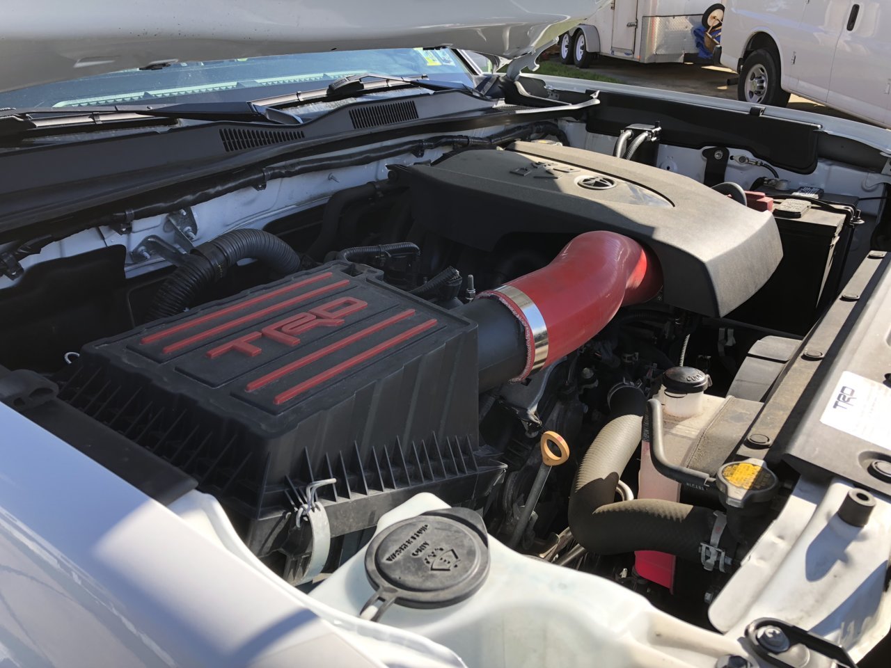

    So I was able to pick off a TRD intake on cyber Monday 2018 for $300 shipped. After installation I felt (1) not much of a difference overall from stock and (2) not much of a sound difference either.
    /on_soapbox
    Now I understand that intakes and people’s opinions on whether they improve or do not improve “performance” are like assholes – everyone’s got one. I personally do not buy intakes for HP gains. I like the sound produced by them (generally) and why I’ve bought them over the years on several different vehicles. That is how I choose to spend my money. And I am blessed that even if after spending 3 bills on an intake it’s not going to have any affect on whether there is food on my family’s table or not.
    /off_soapbox
    I started thinking what could be done to enhance the sound a bit. So the objective became removing the resonator box on the intake tube. I purchased an additional TRD intake tube (PTR03-35160AB), $58, as well as an 8” silicon intake tube from eBay, $8. And got to work. See pix below.
    Today I was able to finally install my TRD intake tube with resonator delete. Here are my initial impressions:
    - shocked that there was now actually some noticeable improved throttle response
    - I’m able to hear some growl now when stompin’ on the accelerator
    My personal take away? If I had to do it all over I’d have gone with the HPS silicon intake tube (57-1600) and possibly the TRD intake flow accelerator (PTR03-35160AE) along with an aftermarket drop in filter. I would have started with the HPS tube and then added later the other parts if I thought they would help.
