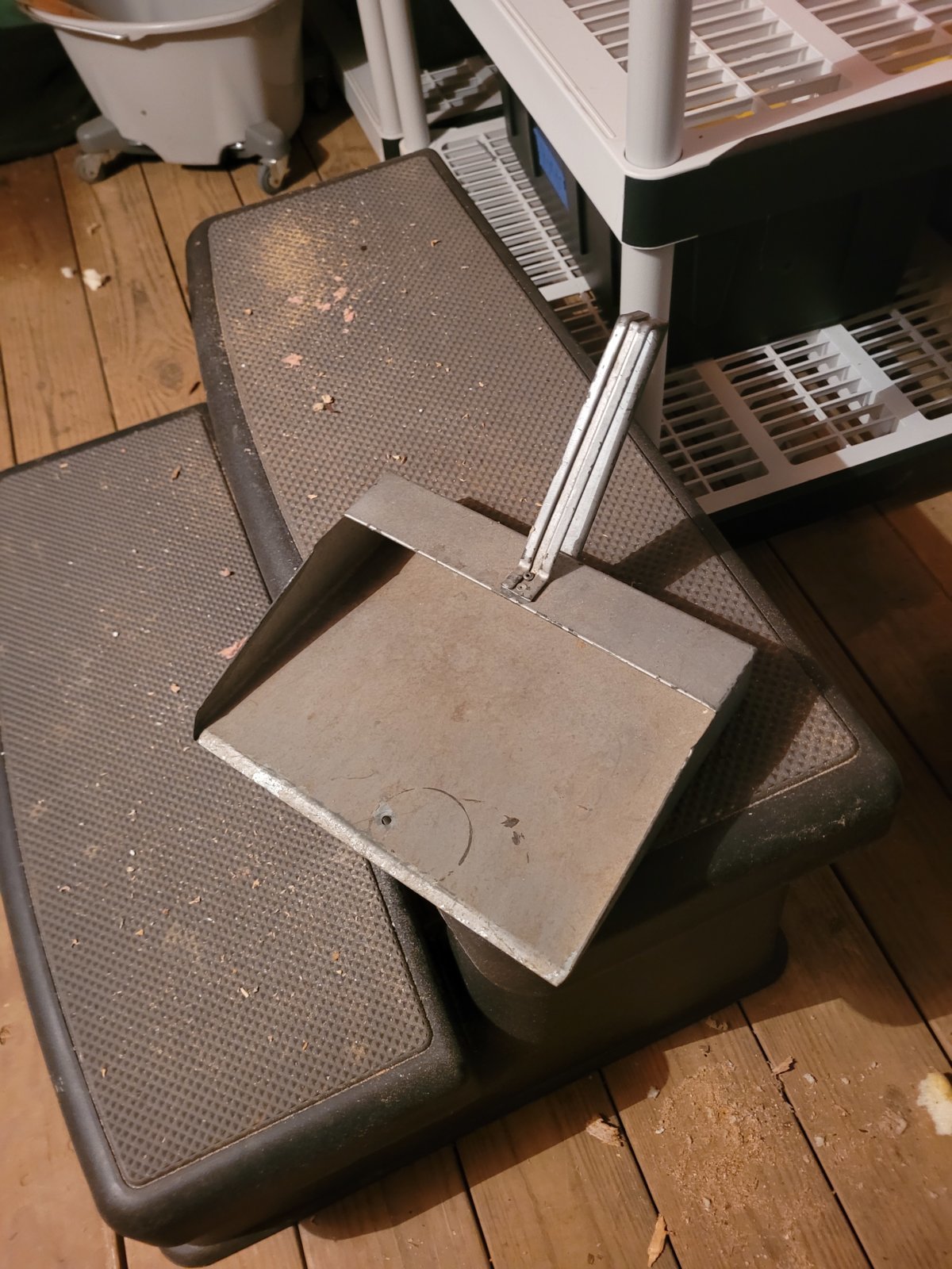

    I made this sheet metal dust pan in shop class back in the 70s and still use it to this day. 20240517_113618.jpg

    Your dust pan looks better than my tool box did. lol
