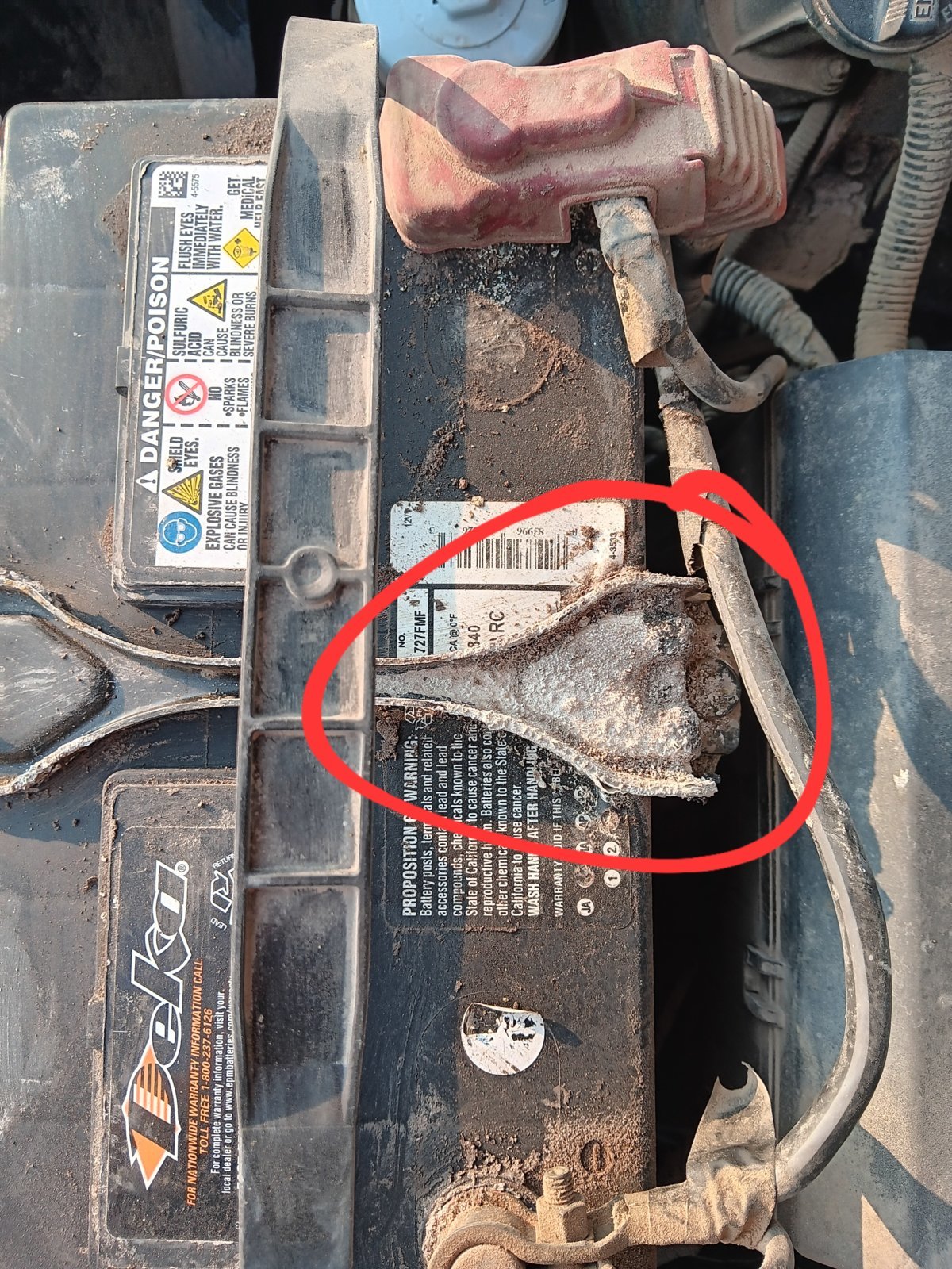

    Is it leaking acid out onto the bracket and corroding it? Battery is from 11/22 the stickers wore off so it's not that old.

    It’s west TX man. I assume it’s pretty hot. Things expand and gas off in the heat.

    Your battery is so dirty that the grime gets on the O rings that seal the 2 square caps. Pop those off with a flat blade screwdriver and clean the rubber seals and the top of the battery good. That will keep the acid from leaking out when you’re bouncing around off road.

    Automotive lead acid batteries almost all leak, it's a good idea to rinse them off every few months or so to prevent the acid from doing damage.
    Baking soda mixed with water works well to neutralize and remove the acid then rinse with water.

    Yeah it's super dusty in west Texas. Also super hot. I can see both those being a problem. Thanks you guys are always helpful on here

    Since you’re in Tx. where’s is pretty darn hot, I would bet your cells need to be checked and add a little distilled water. Most people don’t think to do this and there battery doesn’t last very long.

    Yea dust on the battery allows the acid to wick up and onto everything in contact with the battery.
    If you smear a bit of grease on the battery posts before you install the terminals it helps prevent the acid from getting into the terminals and corroding them away.

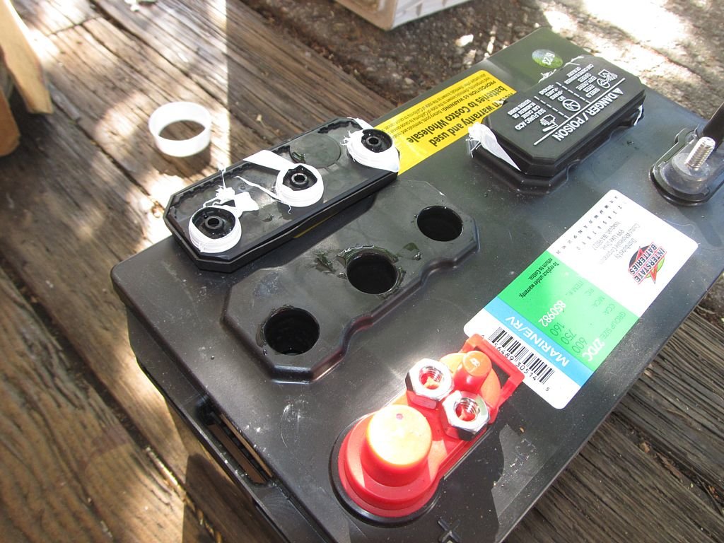

    I've seen very few batteries with rubber seals under the caps anymore, they're almost always a plastic-on-plastic interference fit, which the acid seeps past pretty easily.
    I've had fairly good success keeping them leak-free by wrapping the plugs with teflon plumbers tape (the acid doesn't affect the teflon). Give each plug 1½ - 2 wraps or so (being careful the tape doesn't block the vent holes) then shove the caps back onto the battery.

    Ah cool I got lots of teflon tape and bought some baby water today it is distilled
