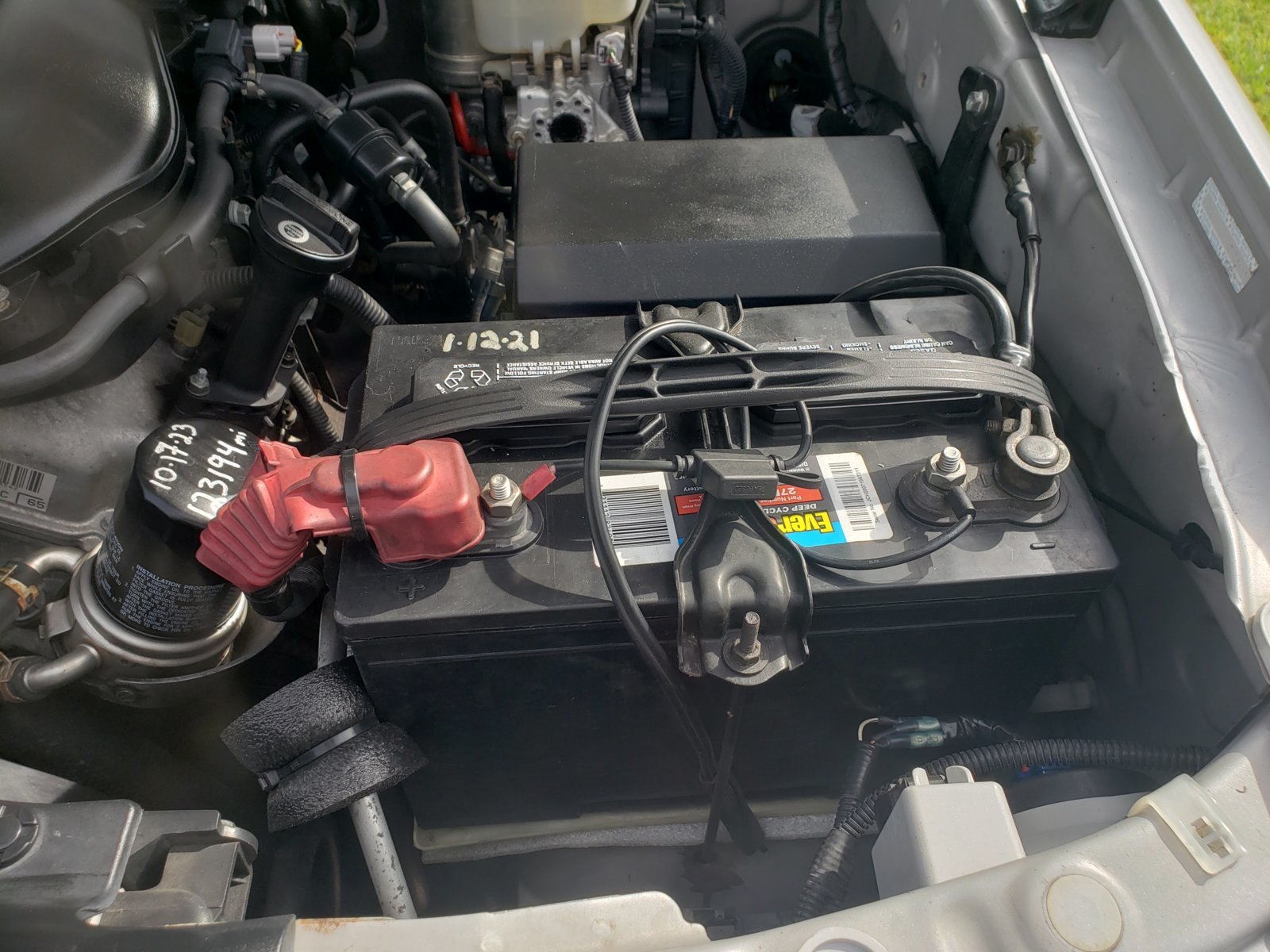

    Regarding the OP;
    You can rinse the engine compartment off with a hose and fresh water periodically. From your pic, I would remove the battery and the bracket, and clean up any grit under the battery. I would then sand, prime and paint ANYTHING that looks rusty.
    You may also wish to add a little cushion for the battery to ride on, as I did. I took a piece of that thin polyethylene packing material (it is like 1/8" thick and white) and placed it under the OEM plastic battery tray in my truck.
    Regarding battery selection; I'll repost the stuff below - again;

    In October of 2014 (6 years) the OEM Group 27F battery died. I almost died when I saw what Toyota wanted for a replacement. That day, I spliced 2" of AWG #6 wire onto the negative lead (which, according to my notes, cost me <$20 for wire, the correct size butt splice, and heat shrink tubing), which enabled me to use a non "F" battery in my truck. The next day, I bought a Walmart Group 27 Deep Cycle Marine battery for $87 in Massachusetts, and I changed the battery in the Walmart parking lot. In November of 2021 (7 years later), while the battery load/resistance tested OK at Advance Auto Parts, I decided that I was pushing my luck, and bought my second Group 27 Deep Cycle Marine battery from Walmart in Florida. This time it cost me $92 with Florida's state tax. I am still running that battery today.
    EverStart Lead Acid Marine & RV Deep Cycle Battery, Group Size 27DC 12 Volt, 740 MCA = 937.5 CCA - I see that the price is up to $94.
    You do you. However, despite the forum-know-it-all predictions of short circuits and the need for a $300+ AGM battery every 5 years in every vehicle (you guys crack me up); in the 10 years that I have been running with the extra 2" of negative lead, and Marine Deep Cycle batteries in my truck, I have had no DC or battery related issues! MY total cost for batteries in the 15 years that I have owned my Tacoma has been <$200.
