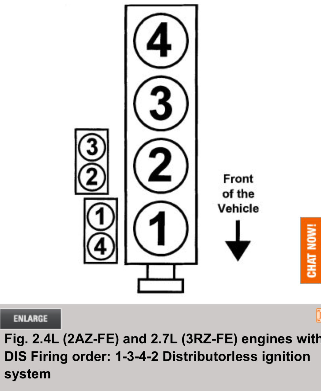

    the cylinder numbers are pretty much straight forward on these. I own a 2rzfe and the pattern on it is straight. should be the same for 3rzfe.

    1996 Blue Tacoma Xtracab 4WD 2.7L
    Yep it is, just thinking where the actual injector is. Looks like I'm going to have to remove the throttle body and air intake manifold just to replace the injector. Kind of a hastle. Unsure if I can get to it without removing a ton of parts
