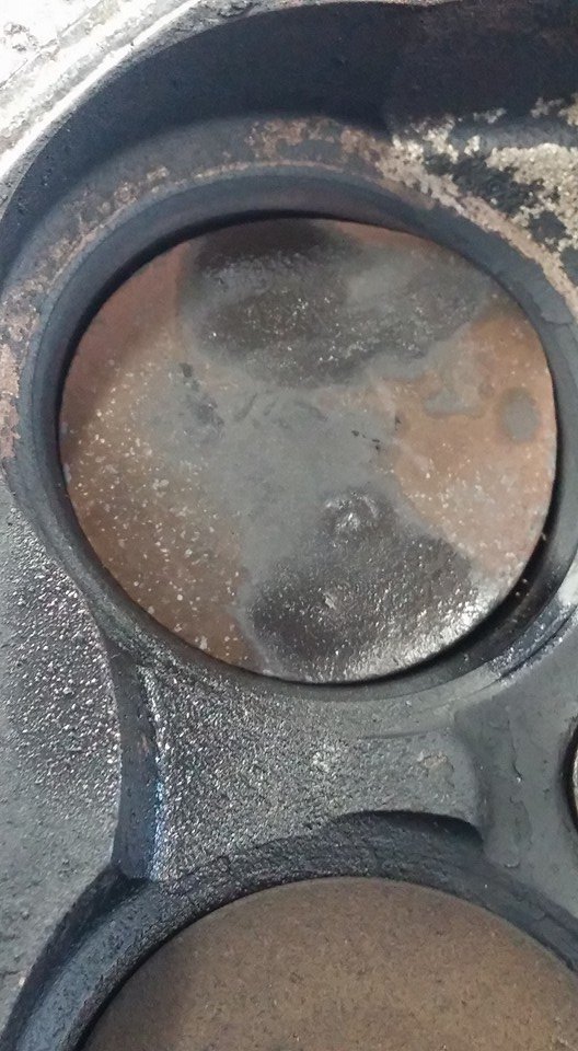

    this was the only photo I found that I took when the head was off.

    I believe this failed because there was never a adjustment.
