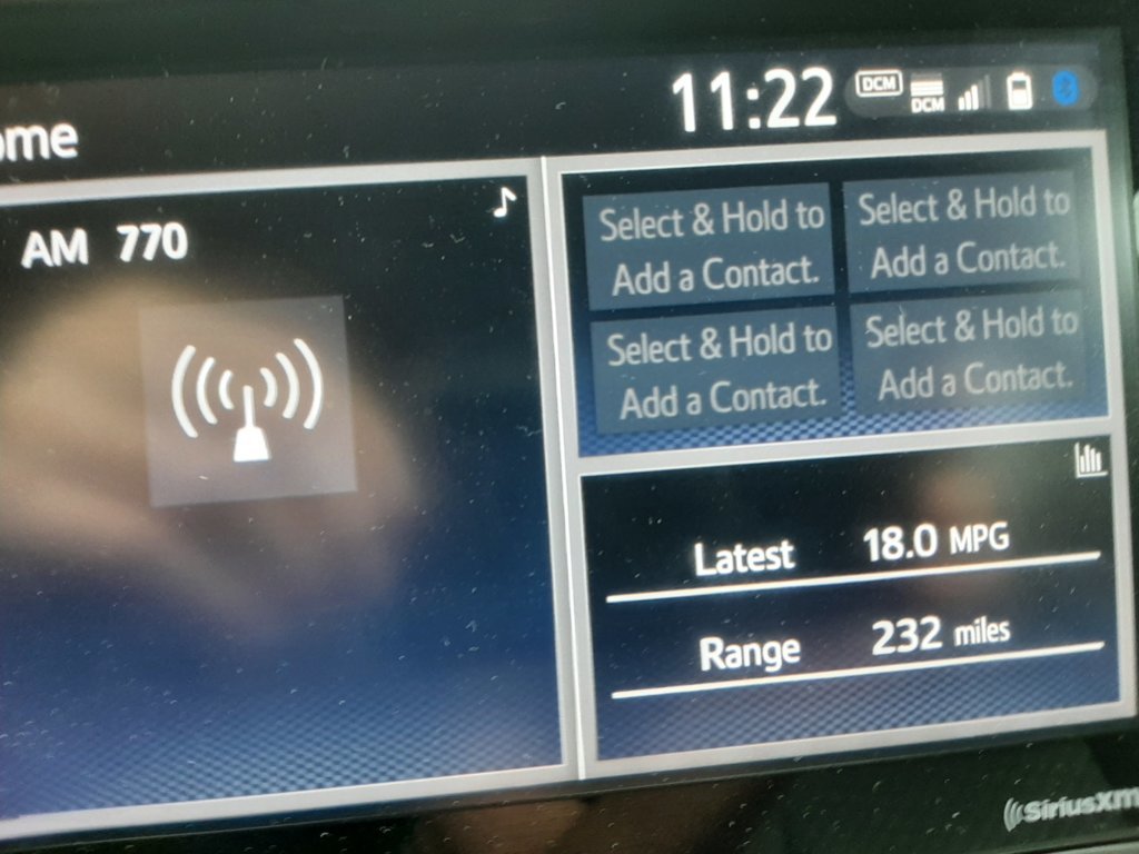

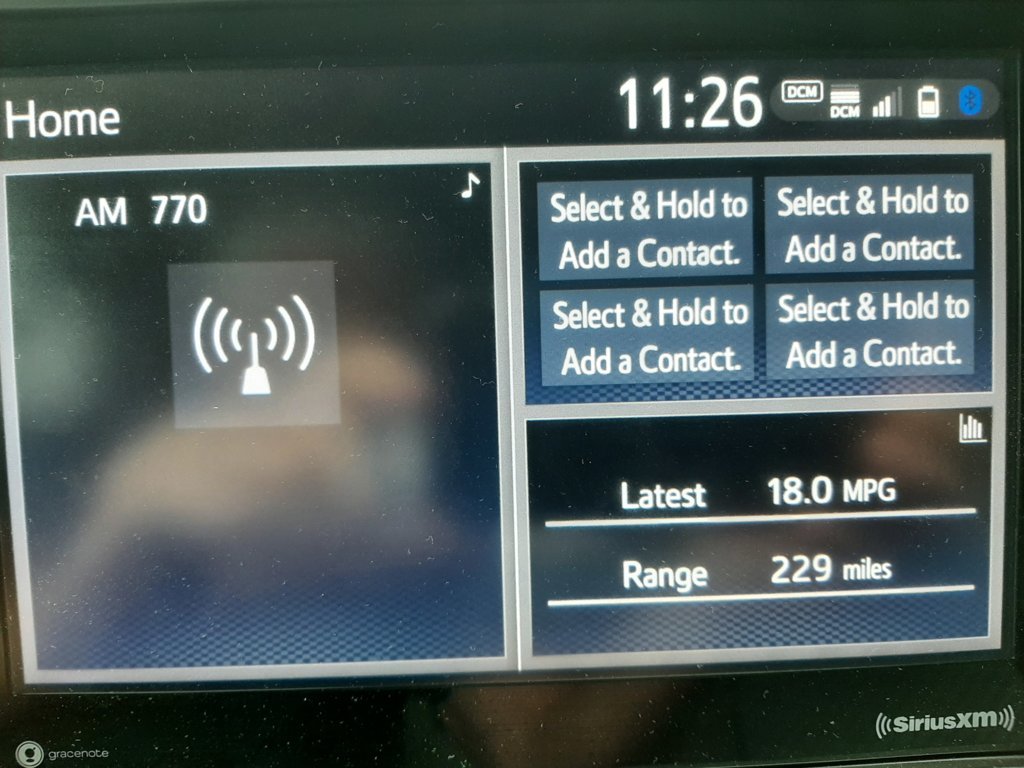

    The phone display on the head unit is usually dim but lights up sometimes.
    It changes on it's own randomly with no input from me.
    I used to ignore it but it is bothering me now! LOL
    When it's dim (greyed out) there is no touch response.
    I'm not sure why. How can I fix it?
    FYI using an Android phone
    Thanks

    I think it has to do with whether the car is in motion. Brightest at a stop but dims when you start to move above a certain speed

    Turn off nighttime mode on HU.

    Have the truck stopped and add a contact to that list by pressing and holding and selecting one.
    Start to drive and you will notice when you drive above ~5 mph that the contact that you added will still be selectable (i.e. not greyed out), but the other three 'Select and hold to add contact' buttons grey out.
    This is a safety feature (just like initially pairing a BT device to the truck) that keeps you from trying to add a new contact to that screen while you should be focusing driving.
    It doesn't have anything to do with nighttime mode or anything else.
