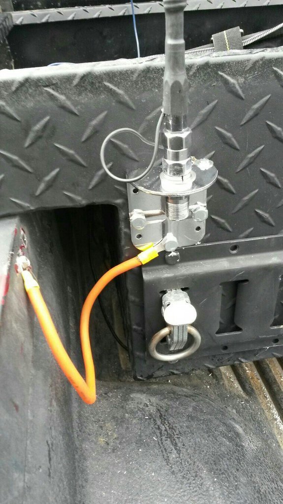

    Im over 3 on my swr and it doesnt matter how I adjust the tip. My current grounding setup is that I have the antenna grounded to the mount and the mount is grounded to my bed rail.

    Dude!!!
    You don't ground the whip!!
    I am surprised it works at all.

    Its not a No ground plane whip.what do I do with the black wire with the ring terminal coming off the antenna then?

    But even with it detached and the mount still grounded im over 3 on my swr.

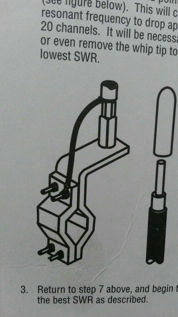

    This is what the antenna packaging shows aqy8uqup_76db856355f8ac681187eb96447d2b51701bb590.jpg

    They come that way

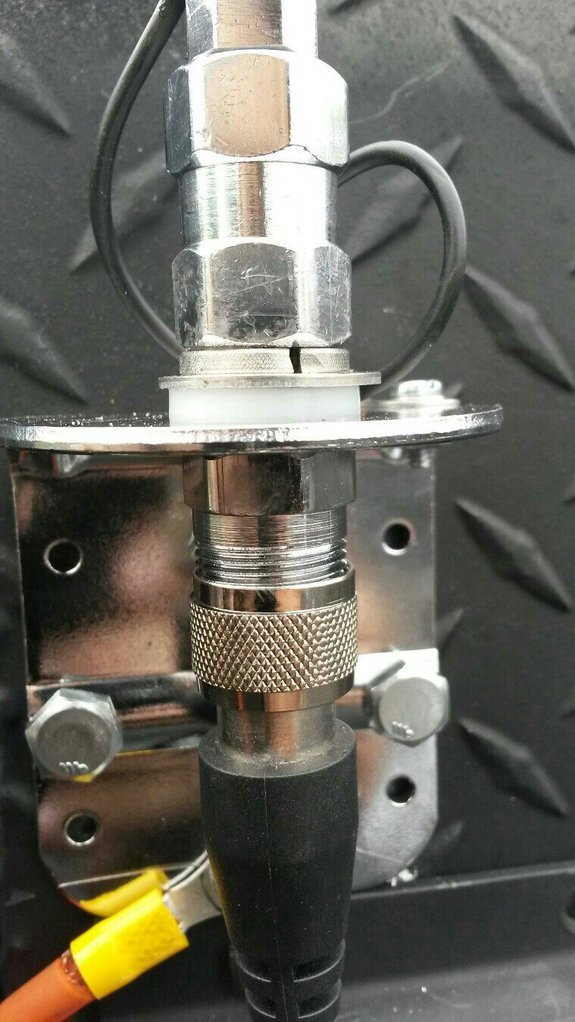

    OK,,, but I think I see a problem with your mount.
    It looks like there is a insulator missing.

    Is that a Firestick mount?

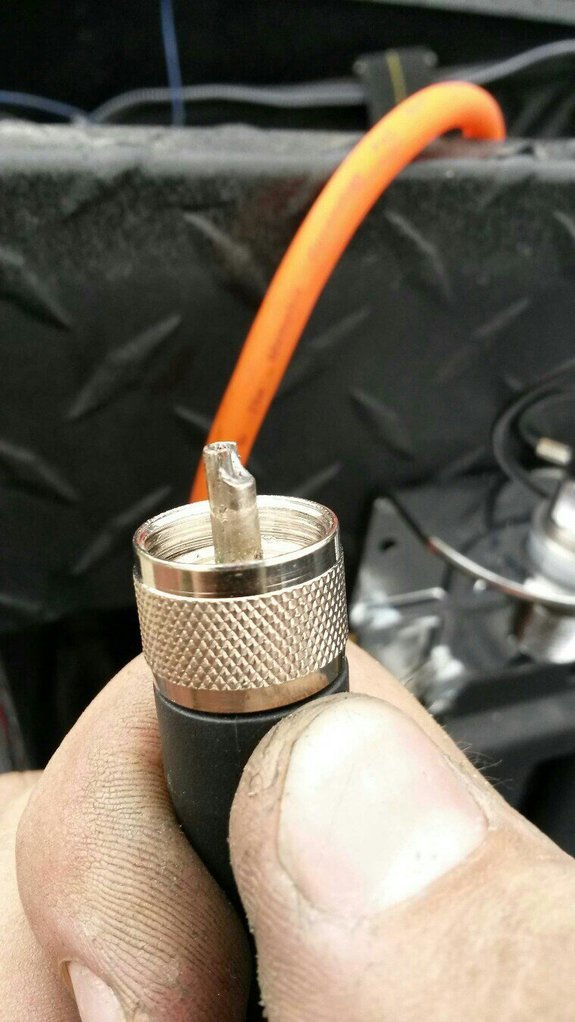

    Fire stick mount, wilson flex 4' antenna. And I just noticed this on my coax. Looked like it arced on something. hu8e2agy_7f79d285326e94763711a816372f9862f9f1154f.jpg

    Is the part of the antenna stud that's going through the hole in the mount touching the mount at all? If so they could be grounding each other.

    No, that is fine, that is how it looks after they solder the wire inside the connector.
    If you have extra coax in the truck spoiled up it should be wrapped in a figure 8 shape, but that only saves you about .5 on your swr meter.
    Everything else looks ok.
    The plastic insulator is in the correct position.

    SWR over 3 generally means that there is a grounding issue. Something is touching where it shouldn't be. Happened to me when I switched over to a firestik from a Wilson.
    Did you put that PL connector together or did you get it that way?

    Take the ground to the frame. /thread
