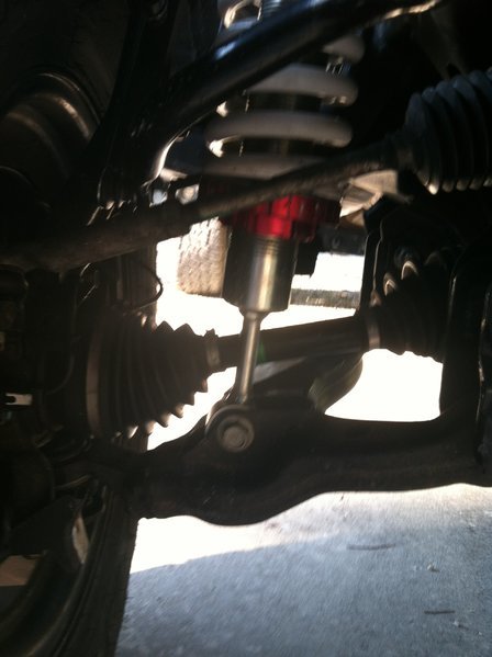

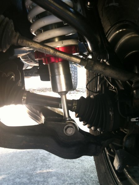

    This fixed mine.

    Is that an aftermarket adjustable shock? Did it come with the springs or is that separate? Where do you find those?

    Freedom off-road
