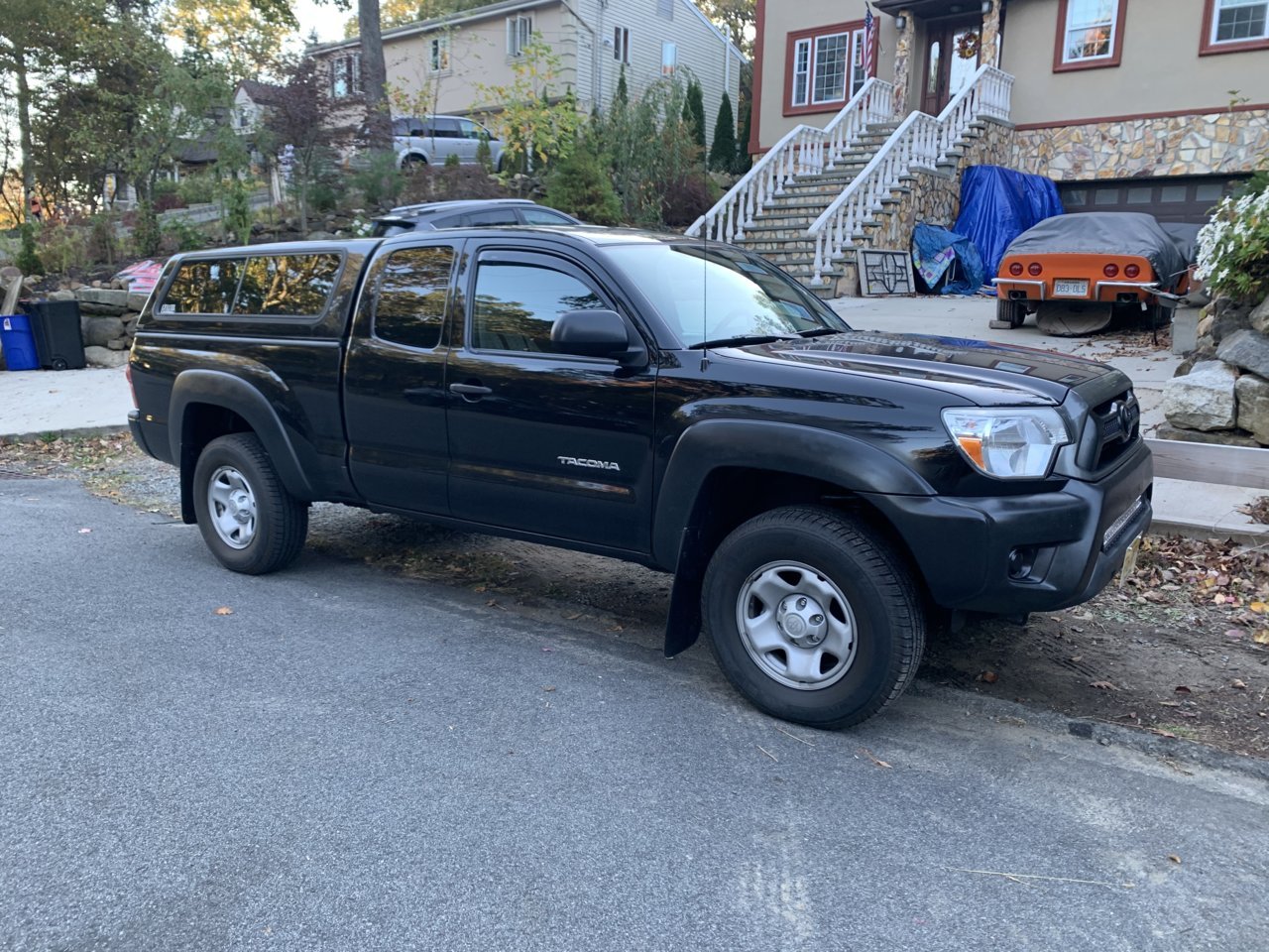

    Also, picked up a cap today after three months of searching. It’s an older ARE Mpulse but it’s in decent shape and I got it for $400. Screened windows/carpeted. Not bad
