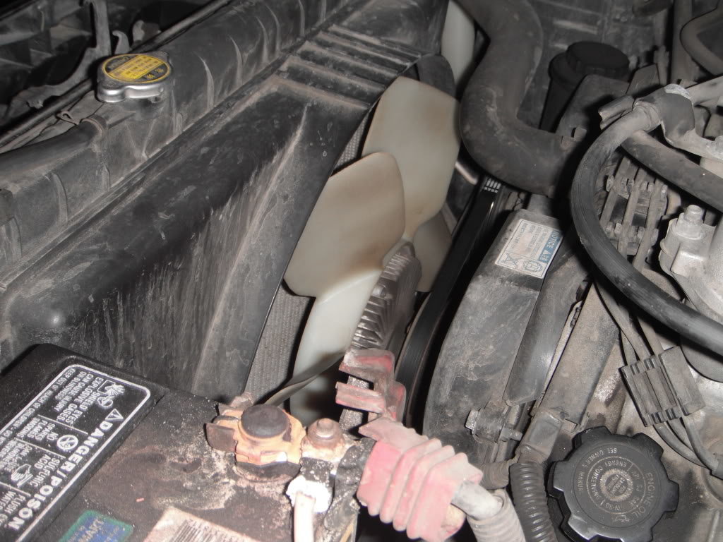

    Here is a picture from where it sounds like the noise is coming from. Just the regular old fan after the radiator.
    Where is the clutch fan located and is this a sign that my clutch could be going out?
    Mine is loud all the time. It is annoying and its all i hear when i rev the engine.

    Loud as in air movement? Or loud as in a bearing that is defective...?

    Defiantly loud as in air movement. It is super loud. Doesnt sound like a bearing or anything being defective like that. Just moving tons of air through the fan is what it sounds like.

    The fan is belt-driven, so higher revs - higher fan speed. Once the truck gets up to to speed, the fan clutch disengages and the fan ceases to be driven.

    it shouldnt be really hard to turn and it shouldnt spin freely. the fan has a clutch on it that makes it is a sense "disconnect" from its shaft on start up so the engine reaches operation temp faster and then once it gets up to temp the clutch kicks back in and it spins the same speed as the shaft driving it. mechanical fans are always kinda noisy so unless its making a really unusual sound then its fine

    Both my trucks make the loud ROAR when you start them up. I know exactly what you're talking about. The 1998 that I sold to my mom takes about a minute for the fan to turn off, my 2000 takes about 45 seconds. If yours is on all the time, you definitley have something wrong that you need to check into.
