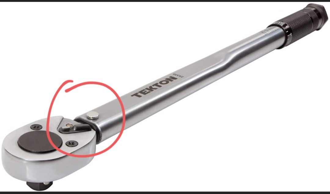

    Deep South
    Herculiner Hootus
    With a torque wrench mr curious.

    Deep South
    Herculiner Hootus
    perhaps @foampile can start a new thread on how to torque reverse thread bolts.

    2007 V6 4WD 6 speed Extended Cab
    I did that, that wasn't the reason
  15. Dec 18, 2021 at 8:27 AM
    #35
    foampile
    foampile Well-Known Member
    Dec 15, 2011
    #68807
    1,081
    Mid-Atlantic
    The problem was not in the wrench switch but because of the flexing of the tensioner, which I hadn't locked

    I have quite a few torque wrenches. A couple have noted in the manual to not use for reverse torque.

    A digital wrench works better than a click type under some circumstances. With a mechanical click. You are fighting to over come the detent.
    Again, in this circumstance. I’d just crank it down by hand. If I were really worried about it. It apply a drop or two if thread locker. But I’ve found the majority of people use WAY TOO MUCH thread locker.
    Never the less, crank her down and move on.
    Jimmyh and Dm93 like this.

    Depends on torque wrench, some are made for both directions. But main thing is dont use it as a breaker bar
