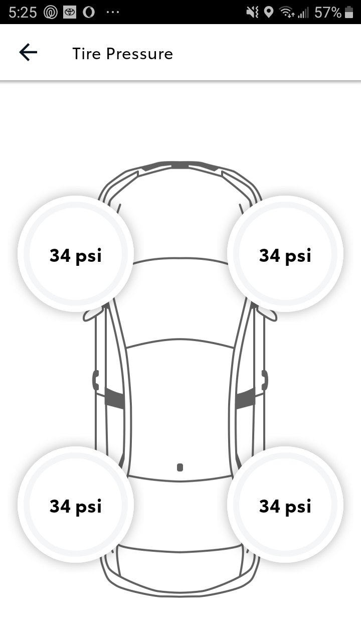

    I have an SR and the individual pressures don't appear on the dash...but on the Toyota Ap on my phone I can see the individual pressures and tire position
    TwinTaco31719 likes this.

    Sorry forgot to attach a picture but here is what it shows for me
  12. Jan 23, 2021 at 5:21 PM

    OH THAT IS AWESOME! I didn’t know this.

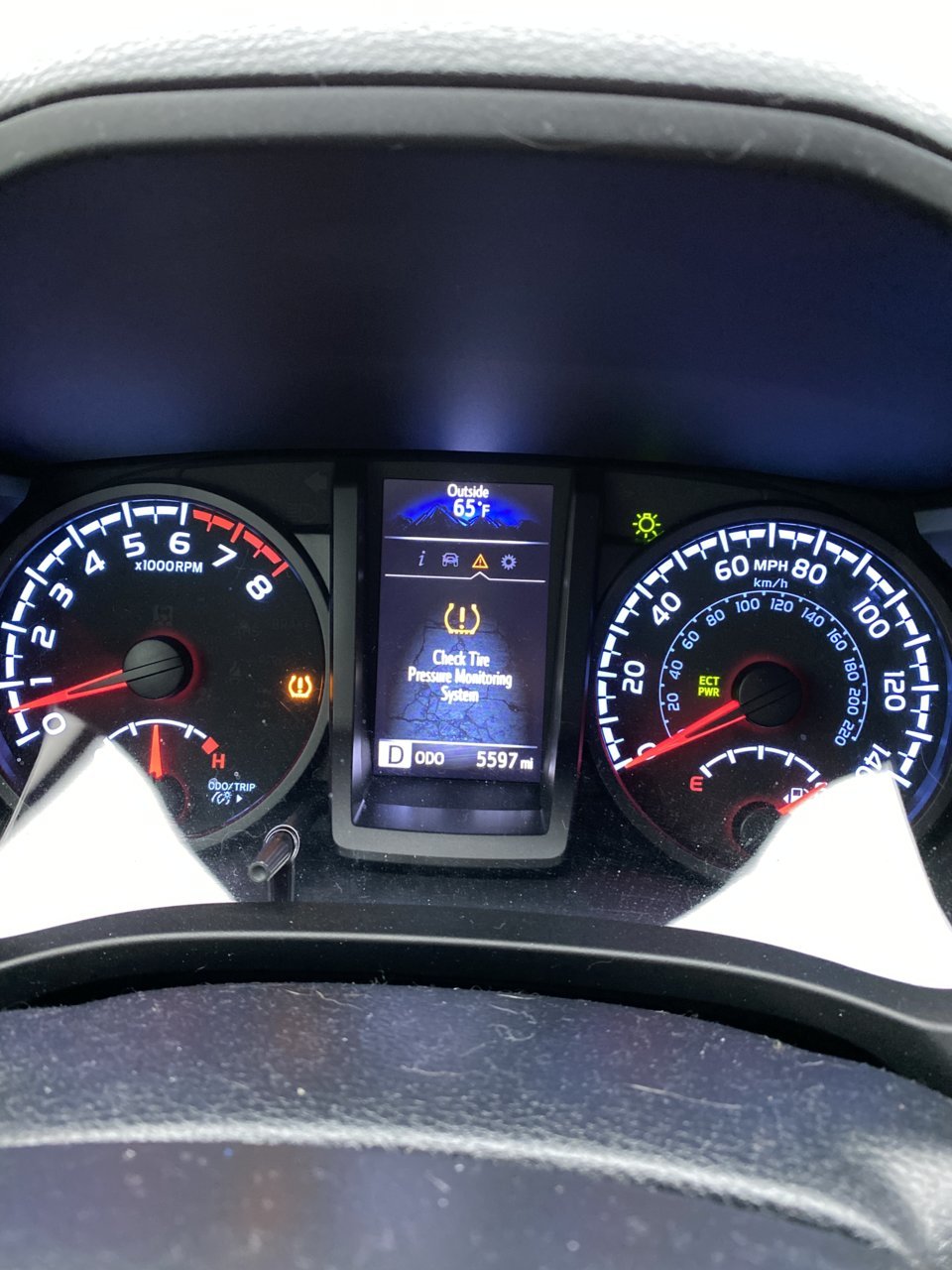

    Currently dealing with similar issues. Steelies came off and new wheels + tires + sensors from Belle tire installed. Worked for a day now my app readout is N/A and tire light is on. Called around to dealerships near me and no one knows the Mhz for the stock steel wheels. Going to take my steelies back to belle and they’re going to double check they have the correct sensors on my current wheels or swap the steel sensors over.
