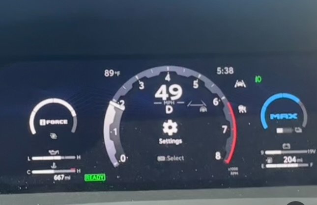

    I’ve noticed since ownership the turbo engages with full blast from the slightest pedal depression. Isn’t this bad or called “lugging?”
    My previous vehicle had a psi gauge and I always tried to keep the turbo from engaging while driving unless slightly until I’m over around 3,500 rpm. This was also a vehicle that put out max torque at 1,500 rpm’s.
    Example; enter highway, stuck behind semi doing around 50mph, traffic is not heavy, I wait for car on the left to pass and I depress the accelerator slightly to change lanes and get up to around 65 cruising speed before the next group of cars comes up behind me. Turbo and MAX gauge go full spool.
    Even going downhill, let off the gas, engine turns off, start going up hill again, depress the pedal, engine starts back up and then turbo is maxed out.
    Anyone have this issue? Any tips?

    OP, are you going by the boost gauge or sound? If the former, you’re pushing the gas too hard for your desired. If the latter, the sound of spooling is not the same as boost
    TruckManNow[OP] likes this.
  20. Sep 13, 2025 at 10:47 AM
    #20
    TruckManNow
    TruckManNow [OP] Active Member
    Sep 6, 2025
    #476930
    41
    2025 Tacoma TRD Sport i-FORCEMAX Premium
    Going by the gauge.
