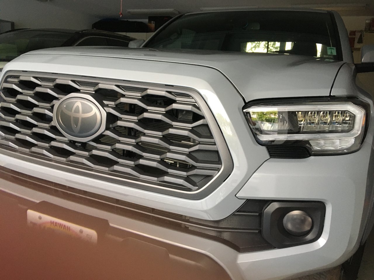

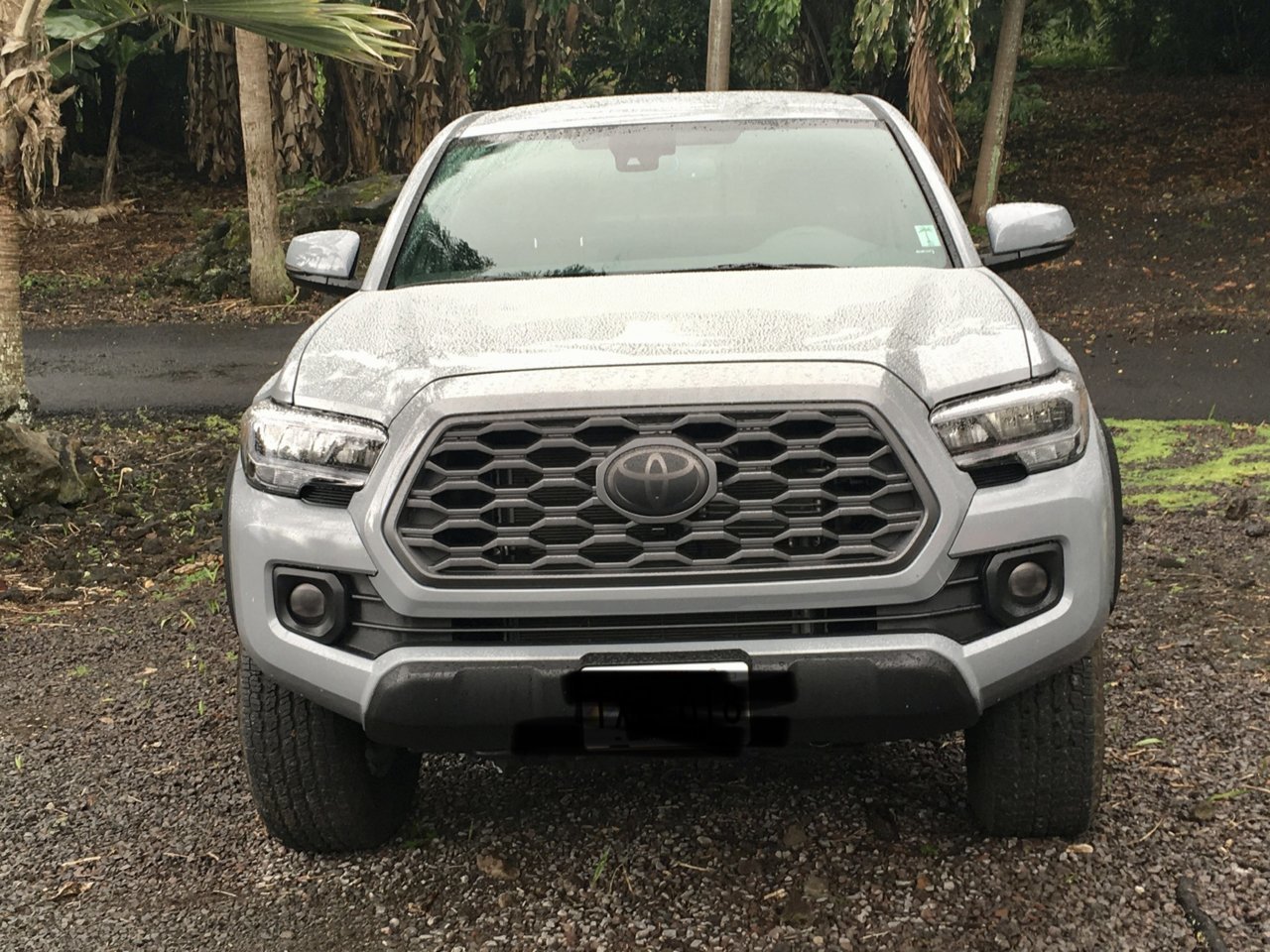

    Tell me about it, over here in Hawaii there are soo many 6”+ lifts on Taco’s and 4R’s and they all have LED bulbs in their headlights and fogs. Guarantee they don’t adjust the headlamps after the lift. The fogs are the worst.
    I put LED bulbs I my wife’s Rav4 fogs, the direction and spread was awful, went everywhere. I took them out and returned them.
    Ive actually put a smoked tint over my fogs (and tss sensor) to get rid of the chrome, don’t ever use them anyway :)
