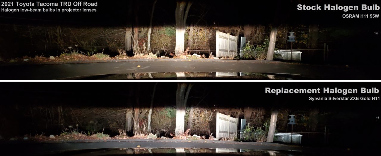

    This thread covers reflectors, like 2nd Gen. For your 3rd Gen, see the 3rd Gen thread. As mentioned the Philips H9 swap is the highest performing, or the Hella 2.0 Performance H9s if you want slightly whiter light. Silverstars are not as great as they seem. The best plug and play H11s are from Tungsram, with their Platinum, Nighthawk Xenon +120 or Megalight +130.
    https://www.tacomaworld.com/threads/3rd-gen-hid-vs-led-vs-halogen-h11-projector-headlights.589465/
