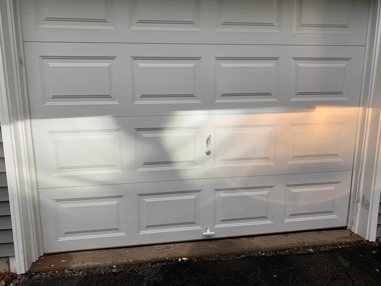

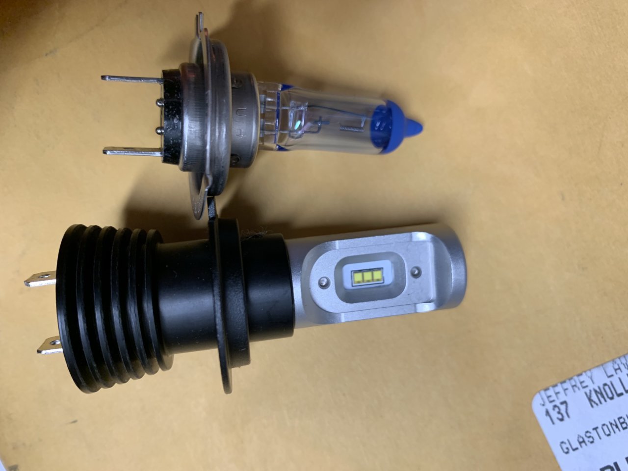

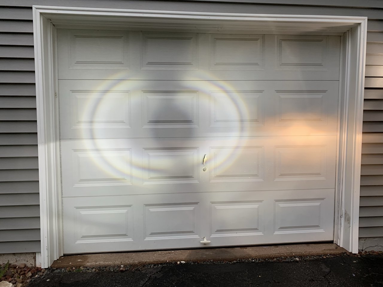

    Purchased the Spyder aftermarket headlights (also found on Tacomabeast) which look awesome but suck for light output. I had upgraded with Phillips halogens which helped some but decided to take a chance on the LED bulbs which in some ways did increase the light output BUT lost the focused center beam found in the halogen WITH lots of scatter. I found the high beam LED's to be more useful than low beam LED's which did not improve the light output.
    I purchased the GTR CSP mini LED H7 bulbs on headlightrevolution.com for $250 (this includes 4 bulbs for low and high beams). This is a high quality LED bulb and figured I would give it a go...
    Driver side has LED bulb, passenger halogen bulb

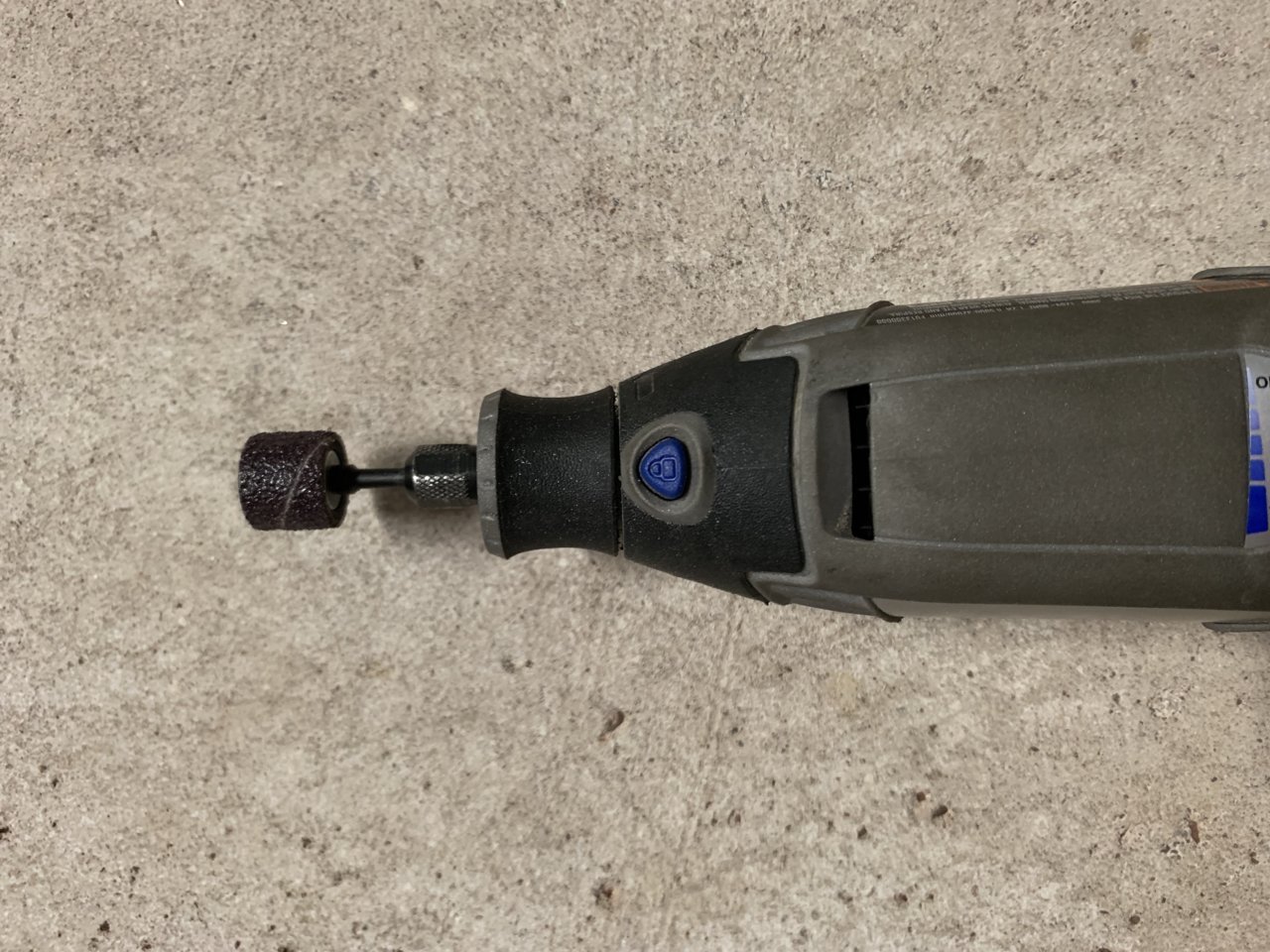

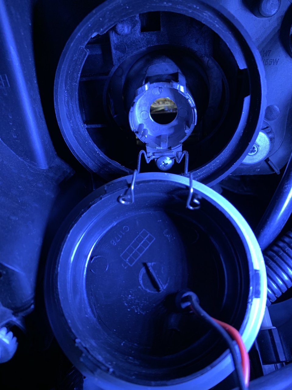

    Furthermore, the bulb housing needed slight modification with Dremel to slightly enlarge the opening which was very easy with this Dremel bit.
    The LED barely fit and was a tight squeeze with regards to screwing the water tight plastic cover back on but it does fit with some patience.
    Lastly, as noted in the beginning, the center beam was diminished with LED's. There is a screw in the LED bulb that can be loosened to rotate the bulb to adjust the lighting pattern. It took some trial and error but there was some improvement. The pic below was the first pic I took comparing the halogen to LED. The LED light pattern DID IMPROVE some with rotating the LED lights (pic not shown unfortunately since it was late at night and got tired of re-adjusting, etc).

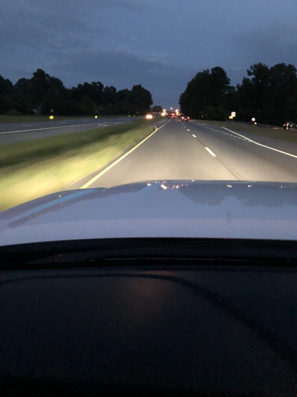

    Do you get decent distance projection on the highway with low beams?
  18. Sep 23, 2019 at 6:38 PM
    #158
    Tape
    Tape Well-Known Member
    Jun 26, 2019
    #297547
    175
    Tape
    2019 Super White OR
    This is low beams and I think they are exactly like the original's but just white, you can clearly see the cutoff and as you can see it is just getting dark and does great when it's completely dark.leds.jpg
    and this is with the fogs
