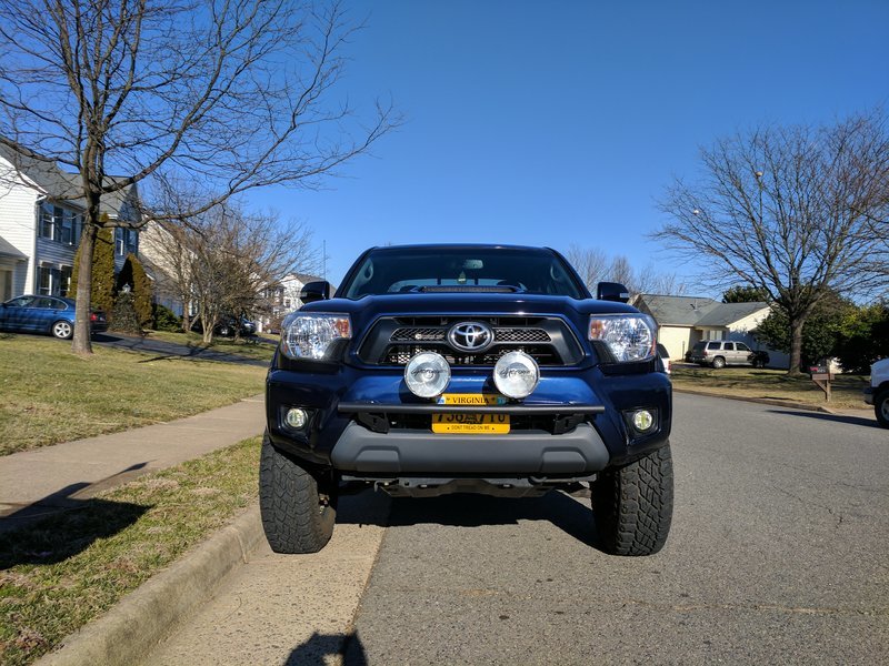

    Here's my setup: 255/80r17 Cooper STMAXX w/ OME 3" lift. I get a slight rub on driver side cab mount at full left lock in reverse while compressing the suspension (like backing out of a driveway)

    thanks kmoto, nice ride. Think if you had a 75 side wall that you wouldn't rub?

    Yeah it probably wouldn't rub with 75s. With the 80s it barely rubs..I hate rubbing with a passion but it's so light and only does it in very specific circumstances that it doesn't bother me.
