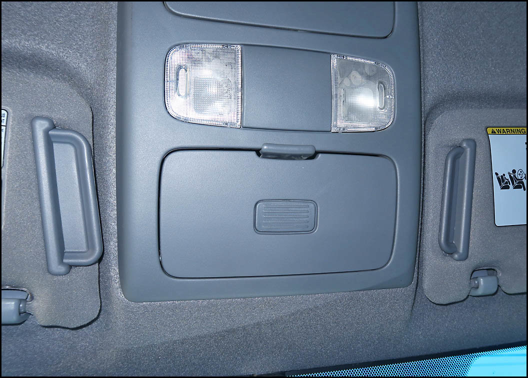

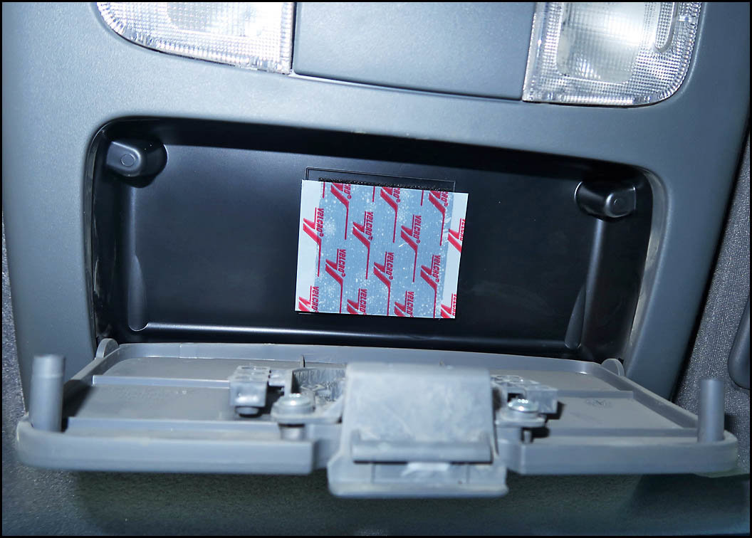

    I have a 2011 SR5 and do not have the temp/direction. I had a loaner rig for a month recently, and it had that feature. I really like that and wish mine had that. There is a space for one below the nav lights (see photos). I’ve always wondered where they put the outside sensor. I would think it could not be anywhere the engine heat or sun would effect it. Are there units that would fit in that space? If so, where would one find them?

    To revive this thread, I just got a 2015 TRD Sport and can't believe it doesn't have a temperature indication either. I now know why there are two sun-glass holders in the overhead console but I'd rather retrofit to that temp module from prior years. Has anyone done this successfully? Is it wired for it still?

    Yes that Gentex looks nice for $260 but so does my stock mirror. It has the homelink/autodimmer/compass display and I like it but the only thing lacking is the temp readout. I also like the OEM look of the previous temp/compass in the overhead console. Is this retrofit possible by replacing the extra sunglass holder with that module? Is it wired for it still?

    I'm still thinking there has to be an alternative to spending $229 to regain a formerly included option. Can't I just get that overhead module from the wrecker and hook it up, and turn off the direction indication in the mirror if I don't like having two compass displays?
    I'm trying to learn if the overhead wiring connector is installed and if the sensor is in front of the radiator already. Any advice on my desired solution is welcomed.

    Doable if your willing to do some work

    That's exactly what I want. Don't mind work at all. Will I find that there is still factory wiring there? Or is that the 'work' you're referring to?

    You need to post a WTB add in the for sale section for someone who has the console (or junkyard) then you use that one as a swap, or cut the temp module out and insert in the sunglass position in order to maintain your bluetooth mic. Then you run two wires from the temp sensor by your radiator all the way to the overhead console and pull power from the mirror plug tucked under the headliner. Hardest part is finding the unit and running the wires. I believe we went into more detail on it in my build thread. Couple of how to threads floating around here too
