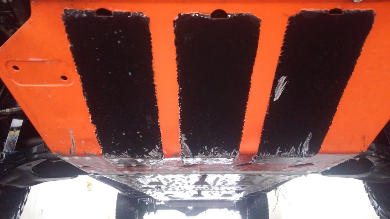

    However if you want to get crafty you can weld inconel (5599) in strategic places.KIMG0861.jpg
    It works well I highly recommend.
