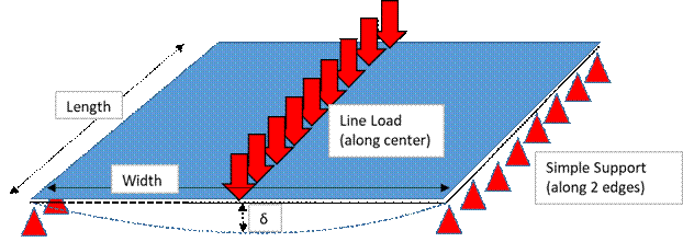

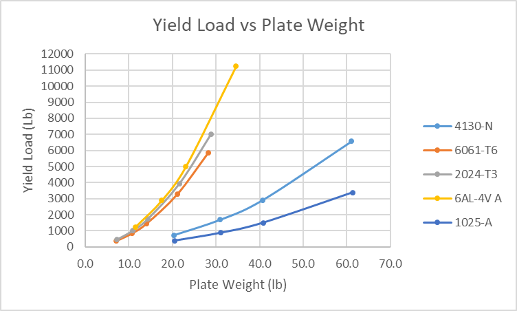

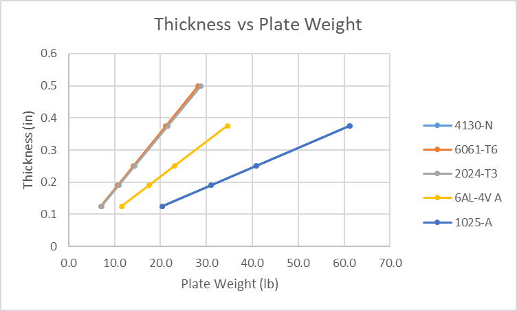

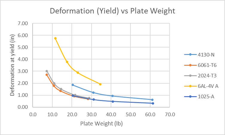

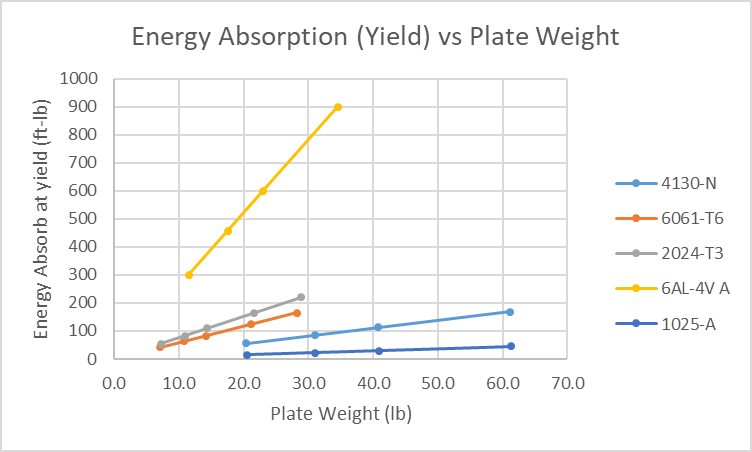

    For shits and grins I compared out different metals during lunch break.
    For this analysis, assumed metals only, various thicknesses. To make analysis easy I assumed a 24"x24" flat plate, simply supported on two opposite edges, and line load down the center of the plate. This does NOT correlate to an actual skid plate, just makes this analysis simple to help compare.
    There are NO reinforcements analyzed, they have HUGE impact on the analysis in real life if installed. Primarily yield conditions are assumed, where bending deformations will be at least partly permanent, even if they do not have any negative impacts. Generally A basis (99% of the population should equal or exceed the value with 95% confidence) allowable are used per MMPDS-01 or MIL-HDBK-5J.
    Note, I have not double checked anything here, so I do not guarantee error free. Again this is comparative only and does not account for stiffeners, gouge resistance, etc.
    Also, I probably should have put 5052-H32 in here too, as I think that is the most common alum skid, 6061 is close but a little stronger.
    All plots are per weight of the 24"x24", because I am emphasizing performance per pound...
    (Didnt do steel or titanium at 0.5", to keep the plot axis reasonable)
    BTW, a flat plate in bending is like the most inefficient structural design in the history of mankind...

    2018 TRD Sport 6MT
    Stronger than all but exotic steels, half the weight (or twice the thickness), more springy-sproingy. However it has a lot lower charpy impact strength than steel which you aren't showing.
