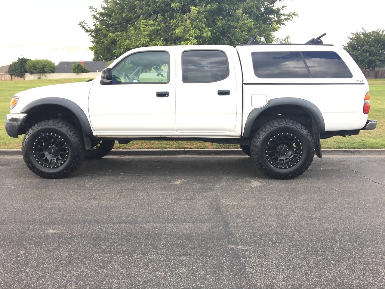

  6. Sep 1, 2017 at 4:26 PM
    Magsrgod
    Magsrgod Well-Known Member
    Oct 13, 2014
    #140268
    52
    New Hampshire
    08 TRD Sport
    Not a magical clean ultra glamours truck picture but this is what it looks like.
