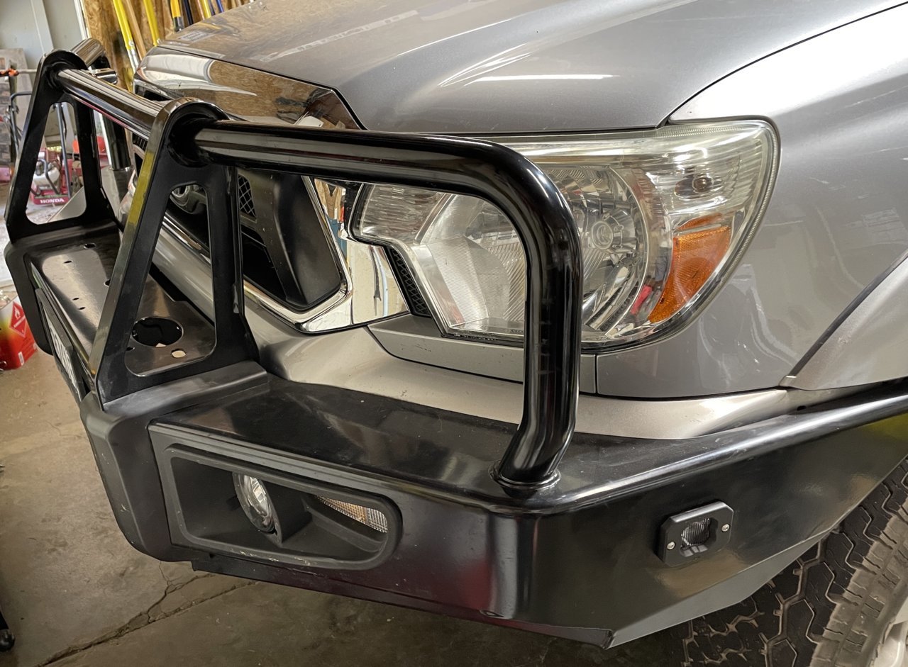

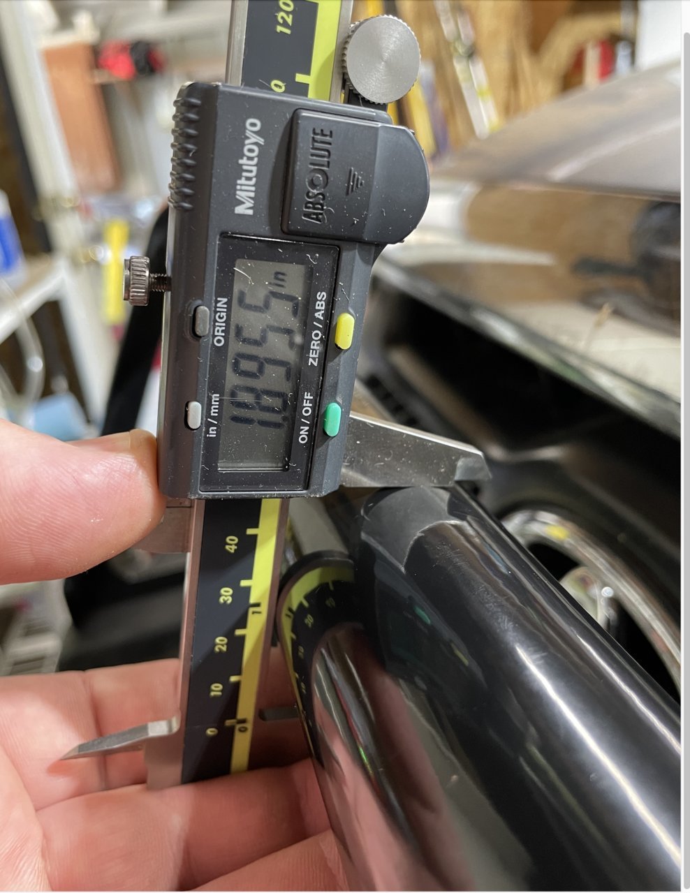

    Measuring caliper is buried moving rn
    does anyone happen to know diameter/OD of the tubing?
    Like front main tube, highest up, of the "bull bar" portion
    Looking at mounting my 60" hi-lift on the tubing, vertically above, using genuine Hi-Lift mounts (cheaper than billet aluminum FourTreks)
    and need to determine size as they come in 1-2" and 2-3"
    Anyone else done this?
    Hopefully coat of oil and boot will protect it there.
    Reasoning behind using legit clamping system is to have solid mounting. Yes people have used hardware on the radio antenna mount holes, but they're designed/advertised as "antenna mounts" not hi lift holder, and can bend.

    I get ~1.895" to 1.900" all along the bar. Diameter doesn't change anywhere across the top or on the down-bend portions.
    Screen Shot 2023-07-31 at 2.22.13 PM.jpg Screen Shot 2023-07-31 at 2.22.26 PM.jpg

    awesome thank you that's exactly where I was gonna put it
    two clamps off the center tube
    seems they changed the OD based on different models over time

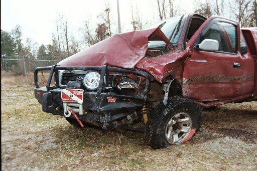

    What make/model was the other vehicle? How fast was the combined closing speed? (Your forward speed + theirs, assuming it was more or less a direct frontal collision?)

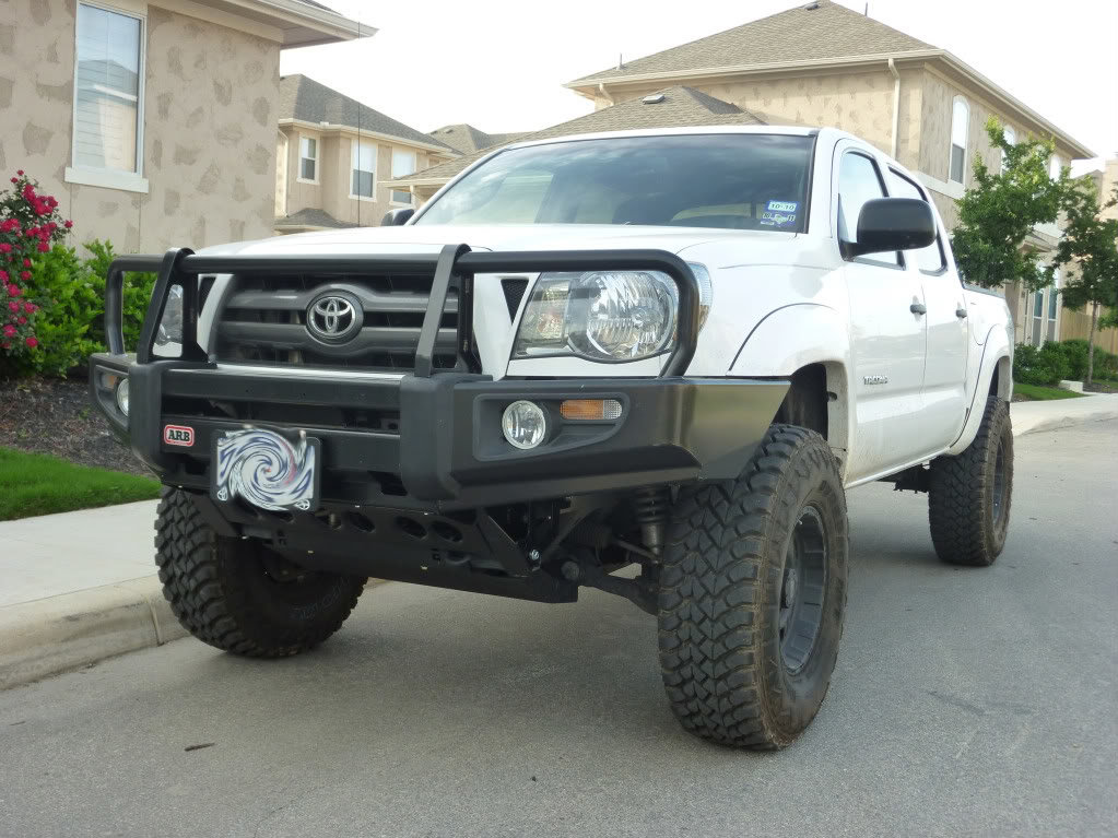

    FWIW this is the "ARB Deluxe Bar", model 3423140, on a 2014 taco.

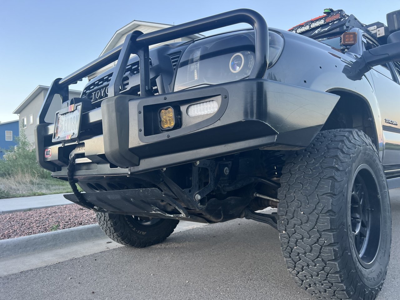

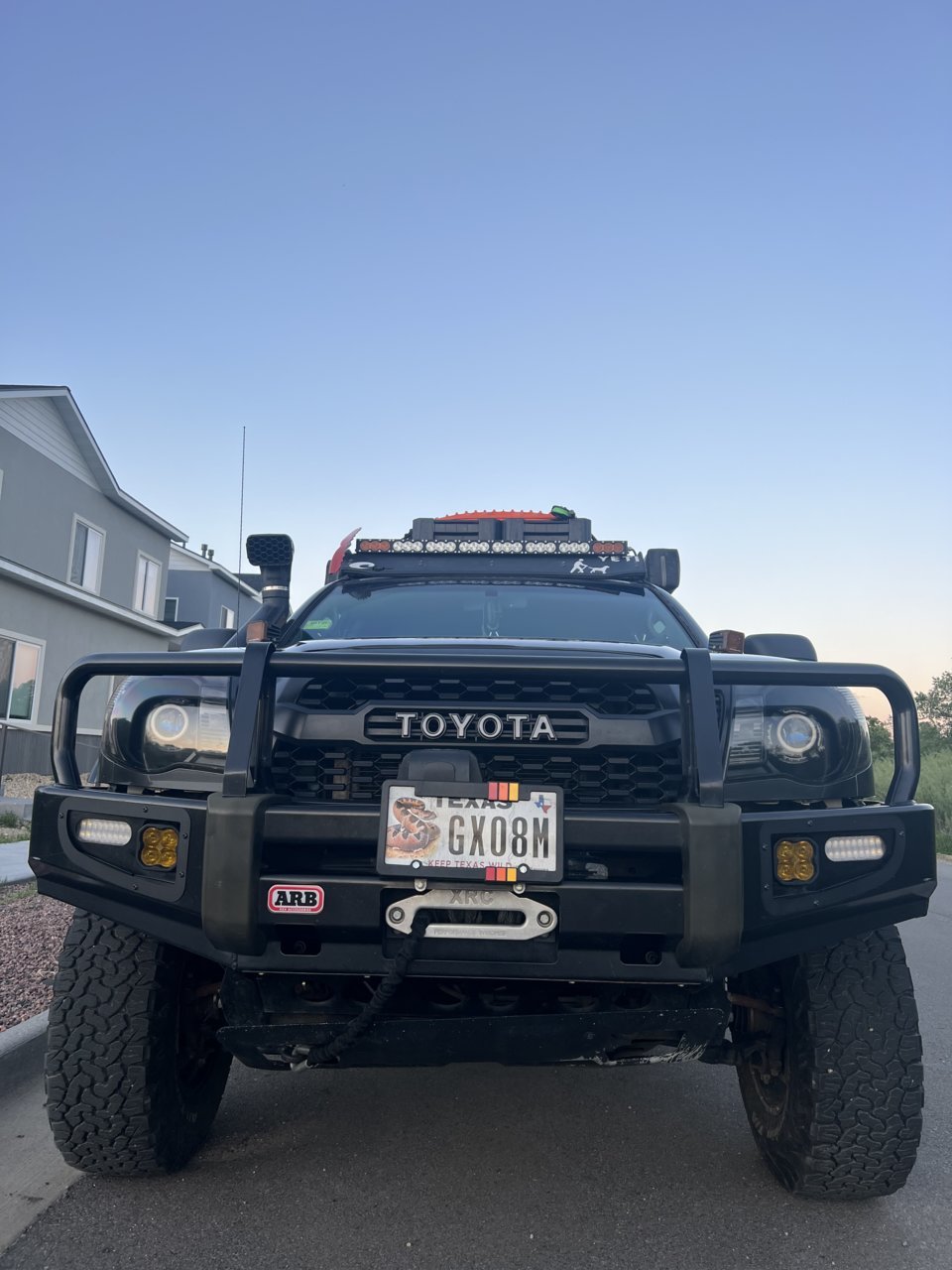

    Went with ARB for the crash testing mostly over anything else. Used to live in Texas where wild hogs were the cause of multiple bad accidents and two fatalities I witnessed personally. Now I’m in Colorado so I have larger game watch out for when I’m on the road at 4AM. Knowing the bumper was crashed tested during design, and that the airbags will go off was peace of mind for me.
    As for other items people mentioned:
    - Black powder coat has never faded or chipped. I do keep it ceramic coated FWIW but it looks brand new.
    - wiring was all done by me and I threw out all the taps and what not ARB provided. Everything was soldered and wrapped to prevent corrosion or moisture from collecting.
    - I installed the ARB LED indicator’s option at time of install. Much better than the halogen housings it came with.
    - used the aforementioned brackets to run better fogs than the halogen ones it came with.
    - use the factory recovery point up front all the time. No need for additional recovery points.
    Without a doubt, this is a very heavy bumper, but so is the rest of my rig, and didn’t want to sacrifice safety for a little bit of weight savings.

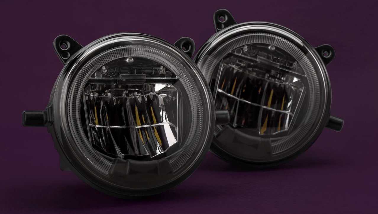

    Re: the fog light openings, at least on my ARB Deluxe Bar model # 3423140 -- An Australian company called STEDI® makes a good set of white LED fogs that are a direct fit for the ARB-provided fog/turn brackets that ship with the ARB bumper. (ARB's "deluxe halogens" that fit this bar are, by all accounts, notoriously dim and worthless.)
    I've been running these since I first installed the ARB bumper ~1 year ago and I agree with the 5-star reviews on STEDI's website. They have excellent throw, full and proper SAE beam cut-off (no excess glare,) good color temperature, good close-in fill & sideways/outwards fill also. Only downside I can think of is that they're probably not hot enough to melt snow.
    https://www.stedi.com.au/arb-deluxe-bullbar-led-fog-light-with-drl-upgrade-kit.html
    STEDI's install instructions show a light-meter output in excess of 400% over ARB's "deluxe halogen" offering:
    https://support.stedi.com.au/hc/en-...D-Fog-Light-Installation-Wiring-Instructions-
