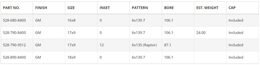

    The best tire sizes are available in 17" wheels. Honestly these are not very impressive. What's the price point? You can get something like Konig Countersteer X in 17x8 at 21lbs each for $250 per wheel.

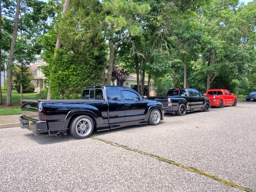

    GearHead899
    GearHead899 Well-Known Member
    Jan 15, 2012
    #70689
    221
    Justin
    Ocean View, NJ
    11' Black X-Runner, 06' RR X-Runner
    I run RPF1's on mine and love them. But for the 6 lug guys, RPT1's are what you want
    4Cylinders[OP] likes this.

    Yep or Konig Six Shooter at 20lb each, 4lb lighter than the Enkei.
