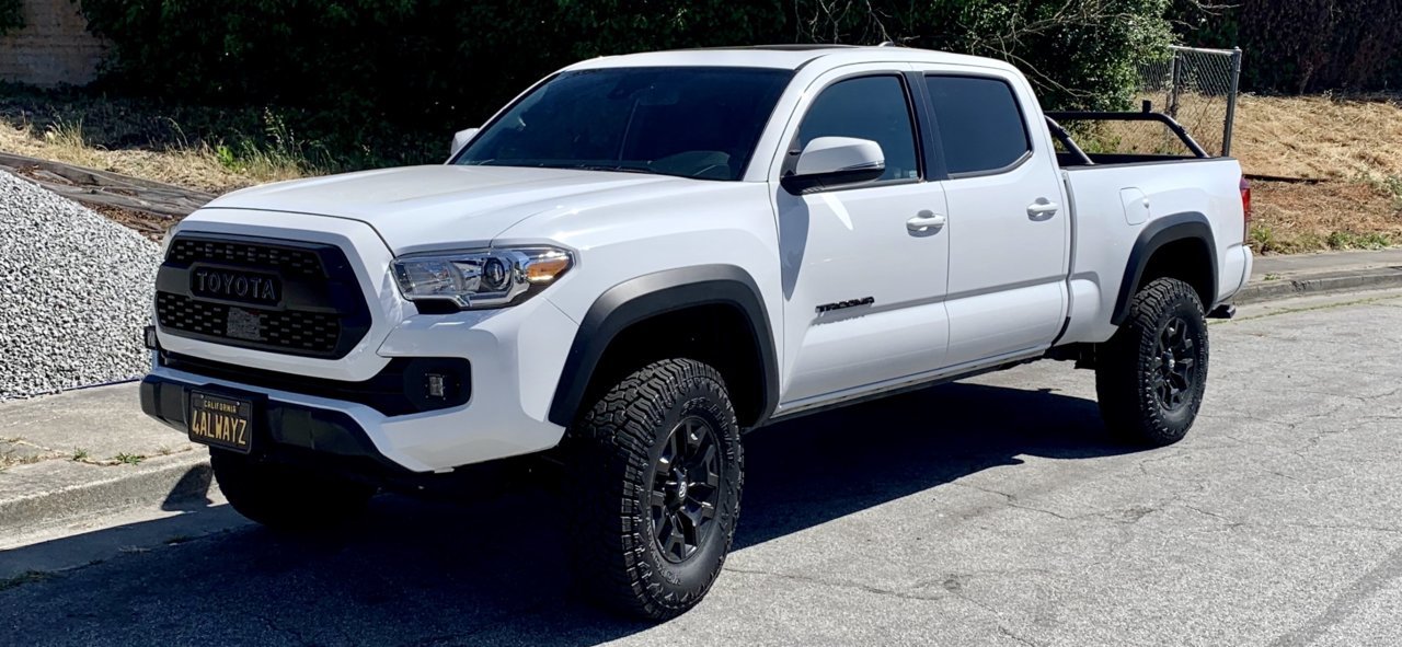

    Kings 2.5” front and rears from Accutune / ICON RXT LEAF PACK black badges doors and tailgate / method 315 / 255/85/16 Yokohama G003 / magnaflow exhaust , axle dump / meso int delete kit / meso led map lights / dome lights / wheelers front super bumps / accutune Flip kit with spacer and new bumps / Cali raised fog light pods / Cali raised ditch lights / RCI FULL SKIDS / SLIDERS / RCI rear bumper / rigid backup lights / tuned on 4.88’s
    5100’s 1.5” front stock OEM coils = No sag / 1.5” Rear AAL.

    Thank you. 5100’s all around and alignment was like $900.
