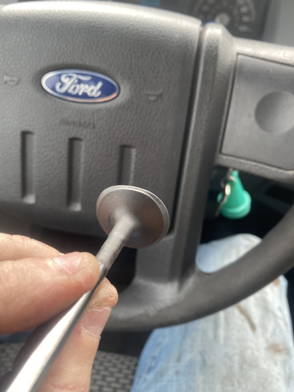

    Been there done that. Pretty sure it wa ms burnt when I got it. Runs way better now.
    I do wonder how many burnt 3rz valves are running around out there.

    About 8 less than there were last month
    Edit: ran fine with these, just a touch of a rough idle

    Yeah mine only had a bit of a miss at idle, gas mileage was good still. Only one burnt exhaust valve.
    Definitely has more power now tho
