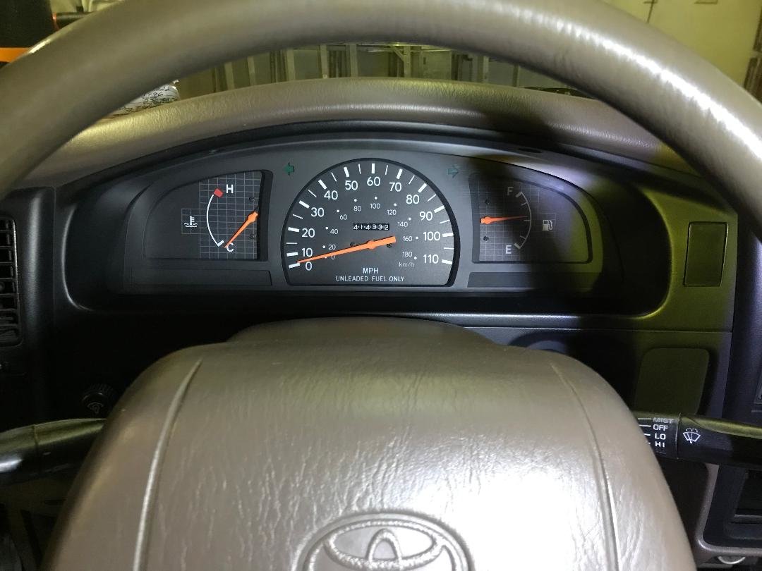

    Kevin Jones
    Kevin Jones Well-Known Member
    Sep 1, 2018
    #264881
    2,218
    Kevin
    Va
    1996 Tacoma - 2018 Tacoma
    Believe I've done a pretty good job of maintaining it over the 26 years I've owned it since new. Otherwise I would not have gotten 415,000 trouble-free miles out of it and it definitely wouldn't be in the excellent condition it is now. ;)

    OpeCity
    OpeCity Well-Known Member
    Feb 28, 2021
    #357705
    3,304
    Long Beach, CA
    99, 24
    It’s very clean, and I didn’t intend that as an insult. But valve adjustment is a regular maintenance item that you seem to be neglecting
