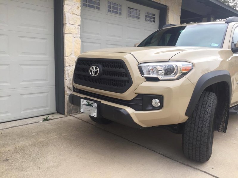

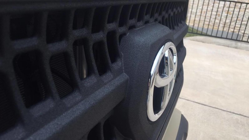

    Holds up great. Much better wearing than plastidip and looks better too imo.
    Buy a 300 grit 3M Scuff Pad and the blue can of Duplicolor bedliner spray and get to work.
    Remove and disassemble grill
    Use scuff pad and rough up the chrome thoroughly. It looks like stainless steel when done.
    Spray light coats of Bedliner from 6-9" from surface moving can rapidly.
    Alternate angle of can for each coat to ensure complete coverage. Wait 5 minutes between coats.
    Keep spraying additional coats until the can is gone.
    [​IMG][​IMG][​IMG]

    Looks awesome and I am going to do it to my grill too.
    I know this is a dumb question but I'm going to ask anyway: Did you prep/spray the backside of your grill? :anonymous:

    Not a dumb question at all. Great call out.
    I did make a quick pass with the 3M pad, wiped it down with the degreaser and sprayed a coat from the back.
