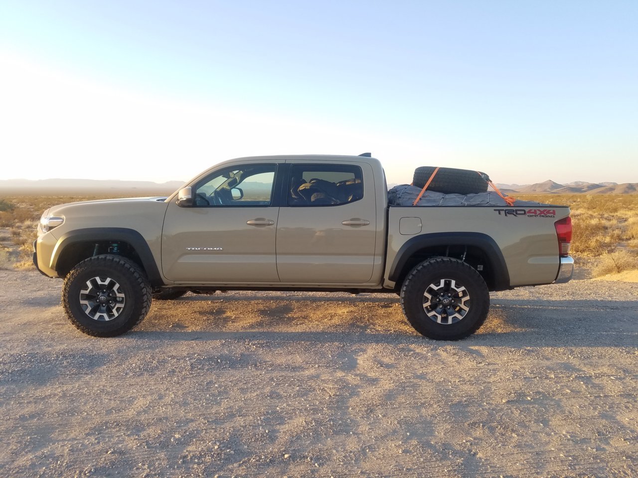

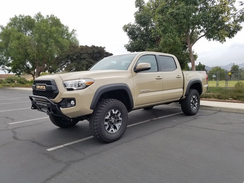

    I'm a form follows function kinda guy. I lifted and kept the rake on purpose. I don't want my ass end in a squat every time I load up to go on a trip. I don't think too many people are looking at the truck and thinking "if only he'd of leveled it".
    This is 2" up on all 4 corners.
    Here's the truck with a decently heavy camp gear load. Ten gallons xtra gas, 5 gallons water, full 110qt cooler....lots of heavy stuff in the back. Little bit of squat, but not bad. And compression adjusters almost maxed out in the rear when with load keeps me mostly out of the bump-stops off road. Would have a serious case of bro-lean going on there if truck had been leveled.

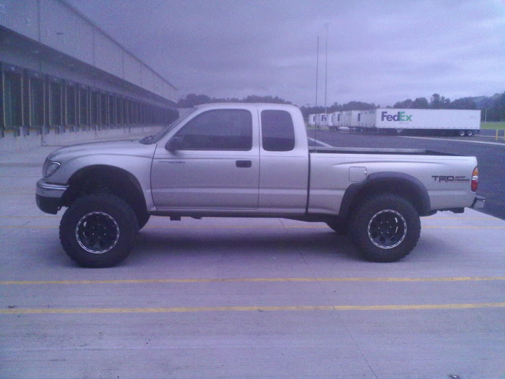

    I see so many pictures of "leveled" rigs and so many of them don't look level at all. They look higher in the front. Looks silly to me. I don’t get it. :notsure:
