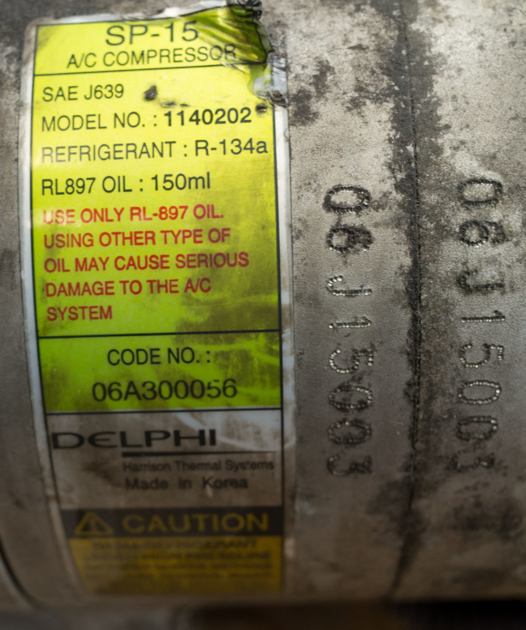

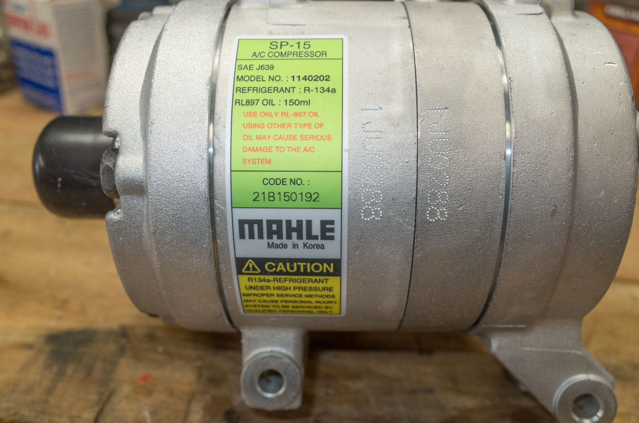

    FYI...just ordered an OEM compressor from Toyota and it's a Mahle. Original was Delphi on my truck.
