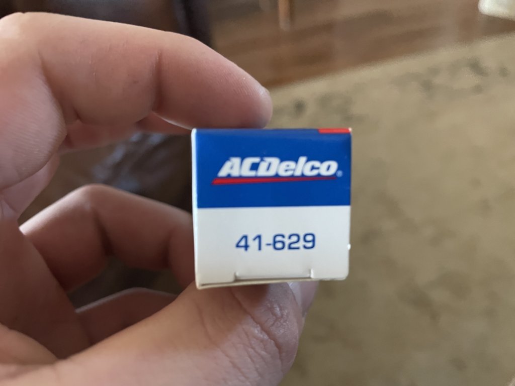

    Okay, thanks for the advice everyone. What spark plugs do y’all run? I have six of these on hand…

    Those show as a correct fitting plug on autozone…
    I’d gap them to 0.44, and put them in if they haven’t been changed in 30K miles +.
    Since theyre copper & these engine fire the spark plug on all cylinders every time a piston hits the top, you’ll want to change them or check at the very least in 30k miles or less.
    There’s a reason that the OEM plugs have 2 ground straps, longevity.
    Or you can get iridium plugs for about $10-13/per.
