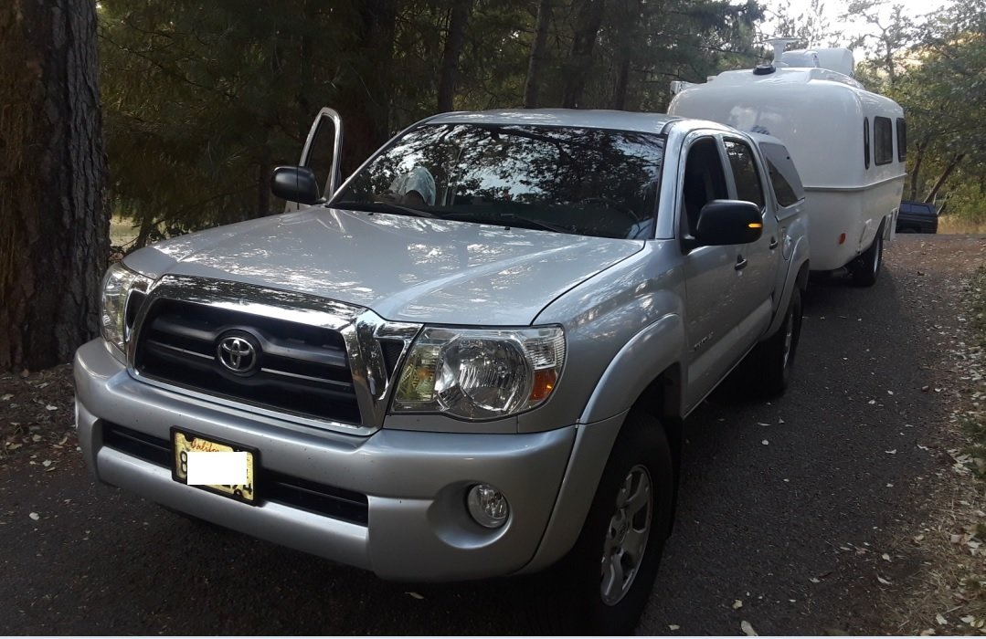

    I have a 2007 Tacoma. I purchased a set of Michelin tires (P265/70R16111T-ORWL) in 2015 for about $725.00 at Costco. It came with 70,000 mile warranty. Same year I purchased a small camper (3000 lbs). I towed it 10,000 miles with my Tacoma. After 5 years I only put 30,000 miles on my Michelin tires. I kept the truck in the garage away from the sun when I was not on the road. People say I should replace the tires since they are five years old. Tires do not look bad. So next time when I purchase my tires I do not want to spend that much money since their general life expectancy is about 5 years and I do not think I would put more than 30,000 miles in 5 years. Does that make sense? I probably put another 10,000 miles on my camper in the next 5 years. Any ideas about a set of reliable and inexpensive tires for my Tacoma ? Thank you
  2. Nov 14, 2020 at 8:17 AM
    LoveableWerewolf
    LoveableWerewolf Well-Known Member

  13. Nov 14, 2020 at 9:37 AM
    Tacowayno
    Tacowayno Well-Known Member
    Oct 23, 2013
    #115053
    84
    Wayno
    Northwest Colorado
    05 AC 6spd, 3"lift, 33's, Four Wheel Fleet camper or Scamp 13', 207k
    Dakar, Boss, Billy's, Bfg AT's on Reliable Racing Wheels
    Nice camper! Casita?

    Yes, it is a Casita.
