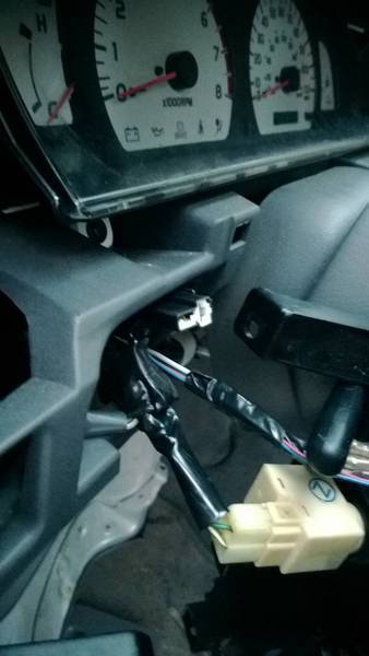

    If you look at the picture below you will see the two white connectors that should be in that cavity behind the dash trim. The one on the left is for the dimmer. The flat one beside it is the one that connects to the e-locker switch.

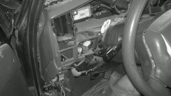

    So here's a picture of behind my dash quite similar to the one above. I noticed there is one wire that was just hanging out, not plugged into anything. It is the top one just hanging out of the cavity.

    Well, you got the light, the wire harness (if the one in the photo is it), and if the locker is attached to the differential, then all you need is a button!
