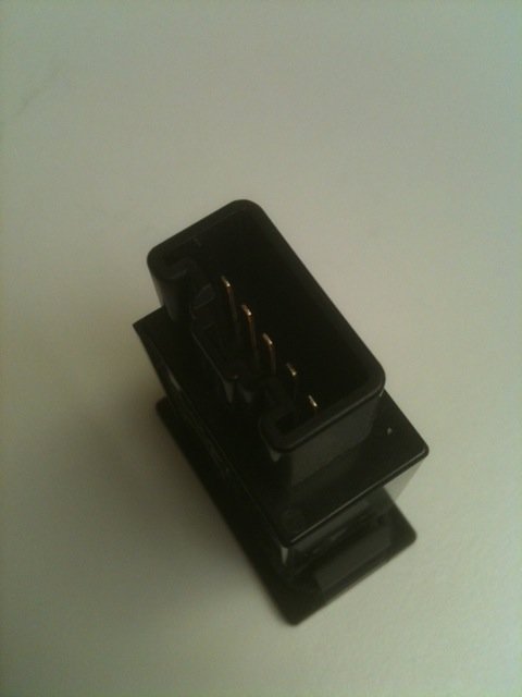

    Not the best photo but here's a picture of the back of the switch:
    What about checking for the gray wire as in the gray wire mod?

    Man, wish i had this pic earlier when i was searching the internet everywhere! I found the plug, i just need a switch. I'll be ordering one tonight so hopefully i can give it a shot this weekend.

    So i ordered a switch off ebay. Hopefully it will be here by this weekend so i can give it a shot!

    UPDATE!
    I received the switch today, installed it, and voila; locking diff. Thank you to everyone here that helped out! I really appreciate it!
