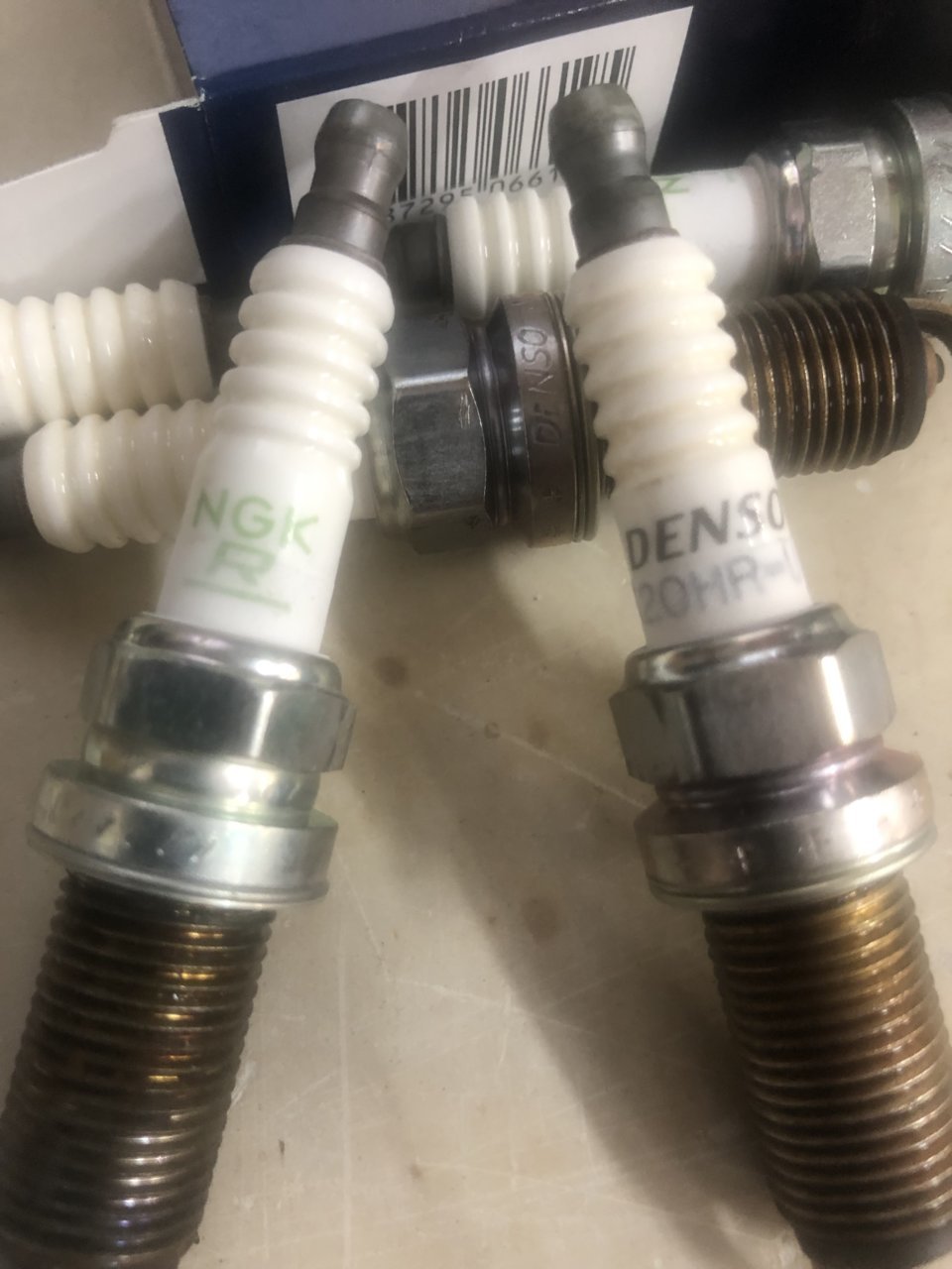

    I have a 2011 Tacoma 4 L V6 just over 200,000 miles. I have never change the plugs finally decided to do so, to my surprise Toyota used two different brands and NGK and Denso, this was strange. Why would they do that? these are the original plugs that came from the factory, I replaced them with NGK iridium plugs.

    They do this to keep both suppliers happy. That way if one can't deliver they have a backup supplier.

    Wow ok thanks for that, I guess that’s a way to keep them in their pocket, but it confused the heck out of me.

    If I Recall Correctly the 2.7 4 cyl specifies iradium plugs, not your 4.0 V6
    Most folks put in a full set of NGKs just like what you took out.

    Do not use iridium plugs on a 4.0 v6

    I was surprised when I saw that too. The Denso looked better when I took them out. I went with Denso.

    What did the tips of those plugs look like?!?!?! Those gaps had to be HUGE at 200k miles on stock plugs.

    I can’t talk about the technical issues but I installed iridium plugs in my 6 cylinder and it ran like crap. I immediately yanked them and installed the regular plugs and it ran great. Just don’t use iridium.

    The replacement frequency on the V6 (every 30k miles) makes iridiums a waste of money. Spark is spark; just because one metal sounds fancier doesn't mean it sparks better.
