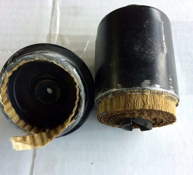

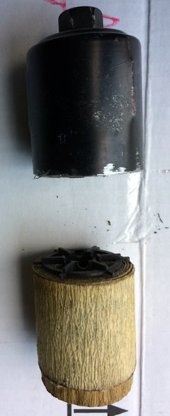

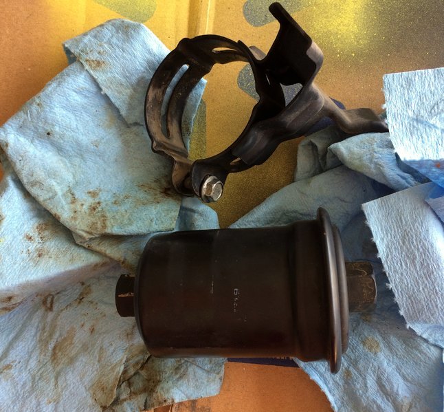

    There are several great write ups on this, but it amazes me the amount of crud the fuel filter stops. This is on my '03 PreRunner 3.4.
    I first changed the fuel filter at around 90,000 miles and changed it again this past Saturday at 141,000.

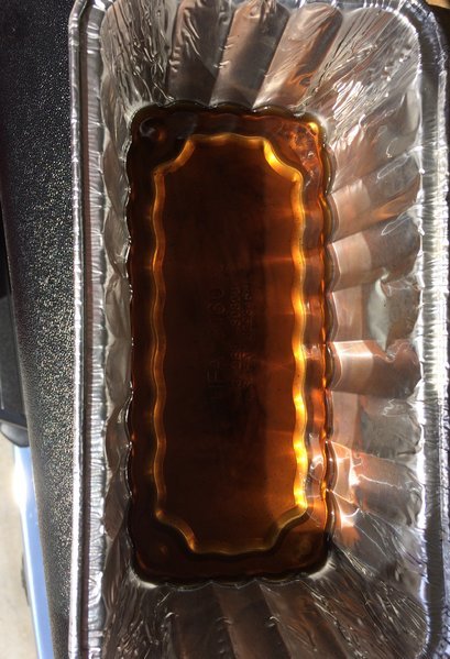

    Hard to see in the picture, but there is mud like grime in the bottom of the pan of gas that came out the inlet side of the fuel filter
    Both times used a Toyota OEM Fuel Filter #23300-62010

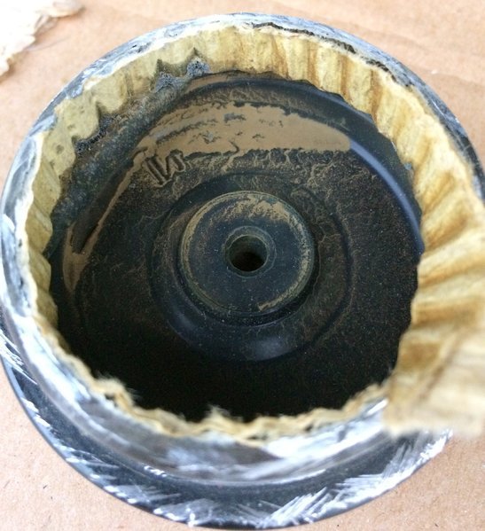

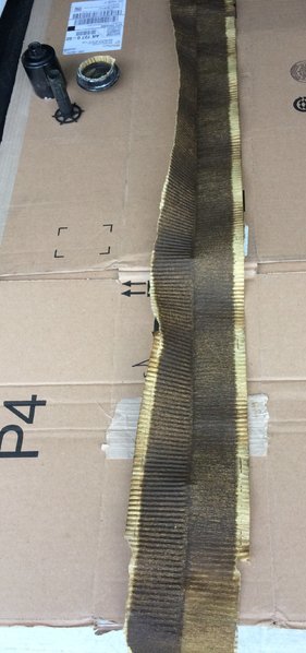

    I'll post up some pictures when I cut it open. I'm curious to see what it looks like on the inside.
    *Last picture below is the new one installed

    I ran a magnet along the bottom of the pan of gas pictured and nothing stuck to it. You can see on the blue towels what was left when the gas evaporated from where the inlet side was dripping.

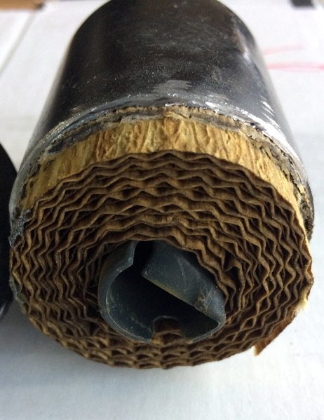

    Cut the inlet side off yesterday afternoon. You can see in the picture more of the brown, dried up silt like deposits.

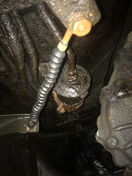

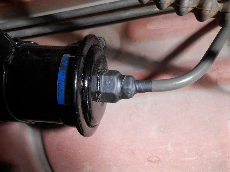

    I tried to change mine on my 02 not having any luck as the fittings are rusted in, any thoughts on how to remove this ?

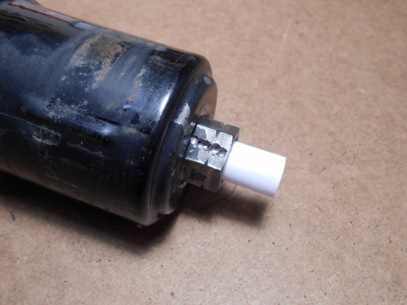

    Not uncommon at all and I figured you would run into this.
    First, use a quality well fitting line wrench, the fit can vary quite a bit. Stop before rounding the fitting or twisting/kinking the hard line.
    I had a fitting rust to the line even after using anti-seize on the threads at the initial install.
    The idea to free it up is to "flex" the threaded female half on the filter. Squeeze the fitting with the biggest baddest pair of channel locks or even better vice grips. Squeeze on the points of the hex not the flats. Try several squeeze and release cycles. With vice grips you can tap the jaws with a hammer to help break the bond. Use the penetrating oil of your choice.
    If this doesn't do it and you still knew when to stop, break out the drill. Drill a row of holes along one of the flats to weaken the fitting then do the squeeze operation again. No need to go too deep with the drill.
    I went a little deep here, but all is well.
    On assembly I still use anti-seize but give the fitting a wrap with that rubber tape that fuses to itself to keep the weather out.
