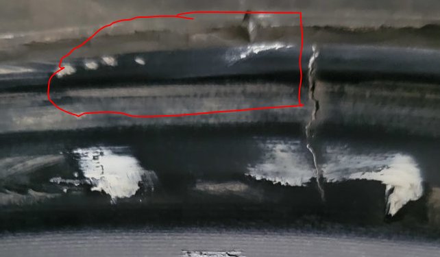

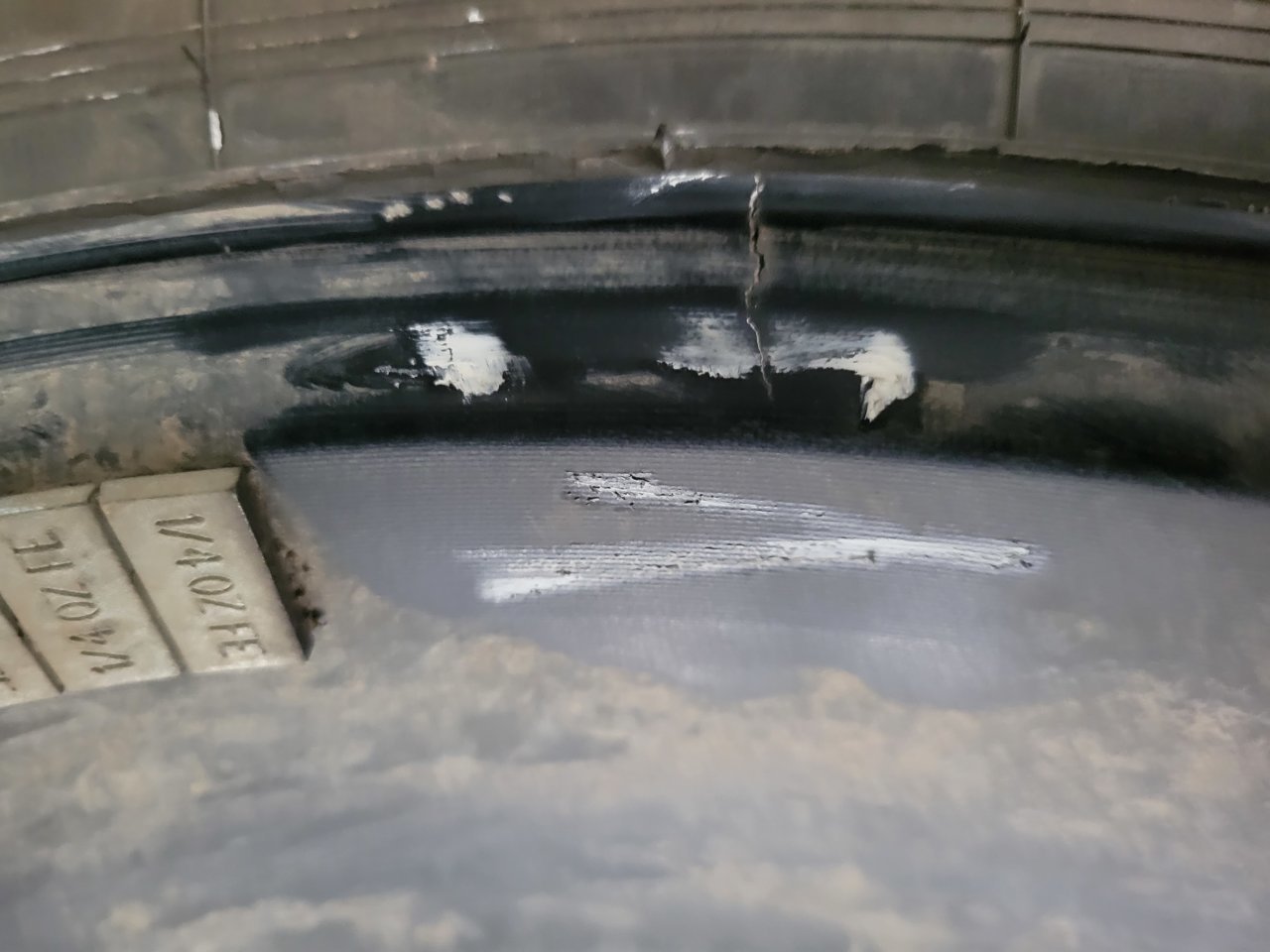

    Noticing that I was losing pressure on my driver side front wheel, I decided to head to the tire shop for a proper patch job. After removing the wheel, the issue was clear, the KMC wheel I had purchased had cracked on the inner lip. Luckily, this should be covered by KMC warranty. During my search for a solution I called a few wheel repair specialists and did a bunch of research. What I discovered was pretty shocking...

    Your crack is from air pockets in the cast aluminum, they are supposed to vibrate the air out after they pour the metal into the cast mold.
    Did you hit any potholes before you noticed the air leaking? Usually, the cause as the weak area takes the beating.
    Below are cheap wheels made from who knows what. They cracked under stress.

    BUT,.... what happened here?

    OP curbed his wheels and blames manufacturing.

    That wheel took a major hit.
