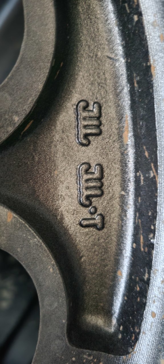

    Bertw192
    Bertw192 Well-Known Member
    Aug 3, 2017
    #225852
    14,437
    Bert
    Seattle, WA
    2017 TRD OR DCSB
    All the things!
    SCS Ray10's are stamped JWL
  4. Aug 12, 2022 at 2:27 PM
    #64
    Key-Rei
    Key-Rei Well-Known Member
    Jun 20, 2017
    #221942
    7,863
    Key
    Florida
    2010 TRD Off-Road 6Spd 4x4 209BSM
    Locker anytime Fog Lights anytime Full LED light conversion TRD cat back Rear cat delete Exaust Y reroute away from actuator Alloy Clutch master 2000 4Runner "Dog Leg" shift leaver Marlin shift seats and bushing Rear seat delete Rear diff breather extension Chrome grille swap Debadge Rear seat delete Honda blower motor beefy plug and wire mod Anytime 12v and USB with volt gauge in bed Blue Sea fuse box Hella AND 70's Caddy horns Low profile recessed hex drain plug swaps Alluminum battery strap 7pin relocated Backup cam on anytime Various other creature comfort and personal taste mods.
    I just confirmed with SCS wheels that all their offerings are JWS/VIA certified!
  5. Aug 12, 2022 at 2:51 PM
    #65
    Bertw192
    Aug 3, 2017
    #225852
    14,437
    Bert
    Seattle, WA
    2017 TRD OR DCSB
    All the things!
    VIA 1000 KG
    Key-Rei[QUOTED] likes this.

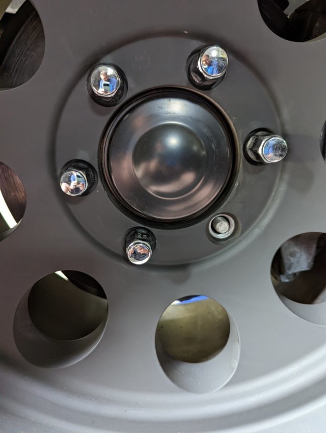

    I wish they were true hubcentric...
    I wish a lot more companies offered true hubcentric.
  13. Aug 12, 2022 at 3:33 PM
    #73
    Key-Rei
    Jun 20, 2017
    #221942
    7,863
    Key
    Florida
    They are hub centric though?
    They fit the hub bore better than my OEM TRD O/R snowflakes did.
    Not sure what you mean otherwise?
    :notsure:

  16. Aug 12, 2022 at 3:40 PM
    #76
    splitbolt
    splitbolt Voodoo Witch Doctor
    Mar 7, 2010
    #32761
    7,858
    NW Arkansas
    2016 TRD OFFROAD DCSB MGM
    Unless it uses flat-washer lugnuts, it is lug centric which has a bore that happens to be sized for the hub.
    At best, it is 50% lugcentric, 50% hubcentric.
    If the center of the bolt circle coincides with the center of the hub bore, it's usually a non-issue. If they don't, the two centering methods fight each other.
    Granted, this has a bore larger than 106mm...see the problem? Hub spacers are not going to solve it.
    Stocklocker likes this.

  18. Aug 12, 2022 at 3:48 PM
    #78
    AmateurTaco1313
    AmateurTaco1313 Next truck will be a Hilux
    Dec 9, 2020
    #349116
    1,244
    ROK
    2018 TRD Sport 4WD DCSB
    Enough for now
    @3JOH22A bro post the whistling diesel video please!!
  19. Aug 12, 2022 at 3:50 PM
    #79
    splitbolt
    Mar 7, 2010
    #32761
    7,858
    NW Arkansas
    Check my edit...
    It is you, who do not understand.

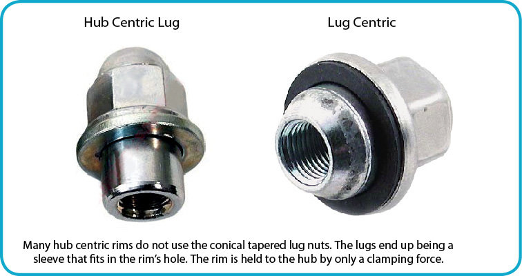

  20. Aug 12, 2022 at 3:57 PM
    #80
    Key-Rei
    Jun 20, 2017
    #221942
    7,863
    Key
    Florida
    The lug nut used doesn't relate to being hub centric, hub centric means solely that the wheel is centered by the hub bore, period.
    Both these lug nuts use a flat washer seat, one is hub centric the other lug centric.
    Full article and extensive information and term definition here:
    http://www.nissantechnicianinfo.mobi/htmlversions/Winter_2012/Hub-Lug_Centric.html
